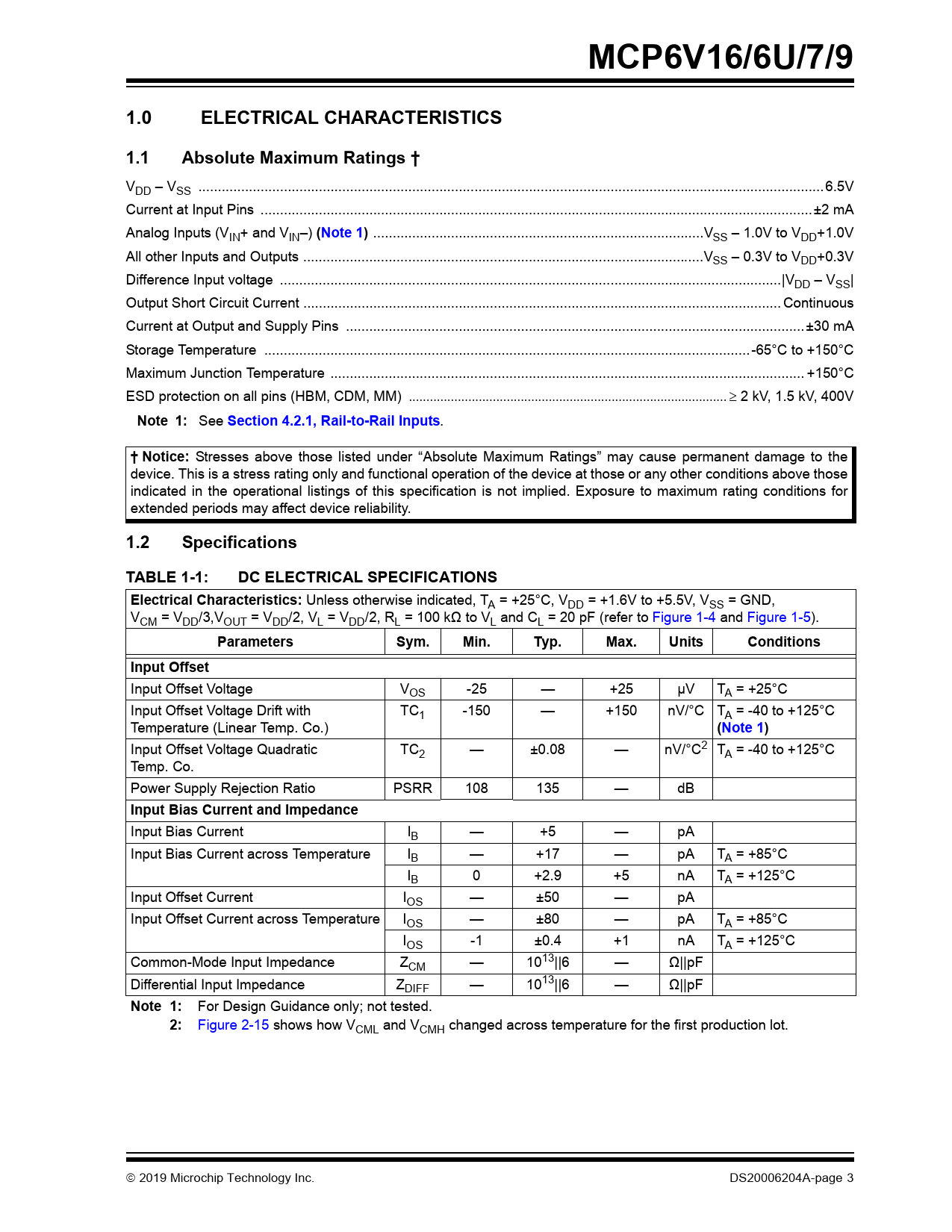

MCP6V16/6U/7/9. 1.0. ELECTRICAL CHARACTERISTICS. 1.1. Absolute Maximum Ratings †. (Note 1). Note 1:

MCP6V16/6U/7/9 1.0 ELECTRICAL CHARACTERISTICS 1.1 Absolute Maximum Ratings †
VDD – VSS ...6.5V Current at Input Pins ..±2 mA Analog Inputs (VIN+ and VIN–)
(Note 1)
...VSS – 1.0V to VDD+1.0V All other Inputs and Outputs ...VSS – 0.3V to VDD+0.3V Difference Input voltage ...|VDD – VSS| Output Short Circuit Current ... Continuous Current at Output and Supply Pins ..±30 mA Storage Temperature ...-65°C to +150°C Maximum Junction Temperature .. +150°C ESD protection on all pins (HBM, CDM, MM)   2 kV, 1.5 kV, 400V

Stresses above those listed under “Absolute Maximum Ratings” may cause permanent damage to the device. This is a stress rating only and functional operation of the device at those or any other conditions above those indicated in the operational listings of this specification is not implied. Exposure to maximum rating conditions for extended periods may affect device reliability.
1.2 Specifications TABLE 1-1: DC ELECTRICAL SPECIFICATIONS Electrical Characteristics:
Unless otherwise indicated, TA = +25°C, VDD = +1.6V to +5.5V, VSS = GND, VCM = VDD/3,VOUT = VDD/2, VL = VDD/2, RL = 100 kΩ to VL and CL = 20 pF (refer to Figure 1-4 and Figure 1-5).
Parameters Sym. Min. Typ. Max. Units Conditions Input Offset
Input Offset Voltage VOS -25 — +25 µV TA = +25°C Input Offset Voltage Drift with TC1 -150 — +150 nV/°C TA = -40 to +125°C Temperature (Linear Temp. Co.)
(Note 1 )
Input Offset Voltage Quadratic TC2 — ±0.08 — nV/°C2 TA = -40 to +125°C Temp. Co. Power Supply Rejection Ratio PSRR 108 135 — dB
Input Bias Current and Impedance
Input Bias Current IB — +5 — pA Input Bias Current across Temperature IB — +17 — pA TA = +85°C IB 0 +2.9 +5 nA TA = +125°C Input Offset Current IOS — ±50 — pA Input Offset Current across Temperature IOS — ±80 — pA TA = +85°C IOS -1 ±0.4 +1 nA TA = +125°C Common-Mode Input Impedance ZCM — 1013||6 — Ω||pF Differential Input Impedance ZDIFF — 1013||6 — Ω||pF
