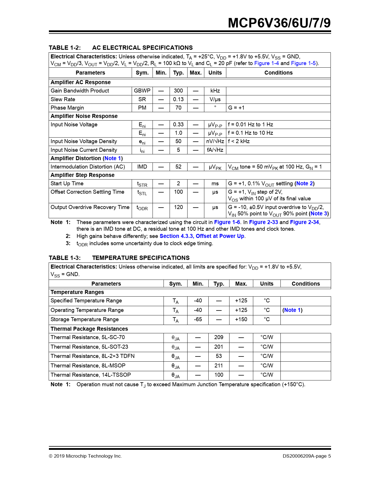

MCP6V36/6U/7/9. TABLE 1-2:. AC ELECTRICAL SPECIFICATIONS. Electrical Characteristics:. Parameters. Sym. Min. Typ. Max. Units. Conditions
MCP6V36/6U/7/9 TABLE 1-2: AC ELECTRICAL SPECIFICATIONS Electrical Characteristics: Parameters Sym Min Typ Max Units Conditions
link to page 5 link to page 20 link to page 6 link to page 6 link to page 5 link to page 5 link to page 6 link to page 13 link to page 13 link to page 5
Unless otherwise indicated, TA = +25°C, VDD = +1.8V to +5.5V, VSS = GND, VCM = VDD/3, VOUT = VDD/2, VL = VDD/2, RL = 100 kΩ to VL and CL = 20 pF (refer to Figure 1-4 and Figure 1-5).
Parameters Sym. Min. Typ. Max. Units Conditions Amplifier AC Response
Gain Bandwidth Product GBWP — 300 — kHz Slew Rate SR — 0.13 — V/µs Phase Margin PM — 70 — ° G = +1
Amplifier Noise Response
Input Noise Voltage Eni — 0.33 — µVP-P f = 0.01 Hz to 1 Hz Eni — 1.0 — µVP-P f = 0.1 Hz to 10 Hz Input Noise Voltage Density eni — 50 — nV/√Hz f < 2 kHz Input Noise Current Density ini — 5 — fA/√Hz
Amplifier Distortion (Note 1 )
Intermodulation Distortion (AC) IMD — 52 — µVPK VCM tone = 50 mVPK at 100 Hz, GN = 1
Amplifier Step Response
Start Up Time tSTR — 2 — ms G = +1, 0.1% VOUT settling
(Note 2 )
Offset Correction Settling Time tSTL — 100 — µs G = +1, VIN step of 2V, VOS within 100 µV of its final value Output Overdrive Recovery Time tODR — 120 — µs G = -10, ±0.5V input overdrive to VDD/2, VIN 50% point to VOUT 90% point
(Note 3) Note 1:
These parameters were characterized using the circuit in
Figure 1-6
. In
Figure 2-33
and
Figure 2-34
, there is an IMD tone at DC, a residual tone at 100 Hz and other IMD tones and clock tones.
2:
High gains behave differently; see
Section 4.3.3, Offset at Power Up
3:
tODR includes some uncertainty due to clock edge timing.
TABLE 1-3: TEMPERATURE SPECIFICATIONS Electrical Characteristics:
Unless otherwise indicated, all limits are specified for: VDD = +1.8V to +5.5V, VSS = GND.
Parameters Sym. Min. Typ. Max. Units Conditions Temperature Ranges
Specified Temperature Range TA -40 — +125 °C Operating Temperature Range TA -40 — +125 °C
(Note 1 )
Storage Temperature Range TA -65 — +150 °C
Thermal Package Resistances
Thermal Resistance, 5L-SC-70 JA — 209 — °C/W Thermal Resistance, 5L-SOT-23 JA — 201 — °C/W Thermal Resistance, 8L-2×3 TDFN θJA — 53 — °C/W Thermal Resistance, 8L-MSOP θJA — 211 — °C/W Thermal Resistance, 14L-TSSOP θJA — 100 — °C/W
