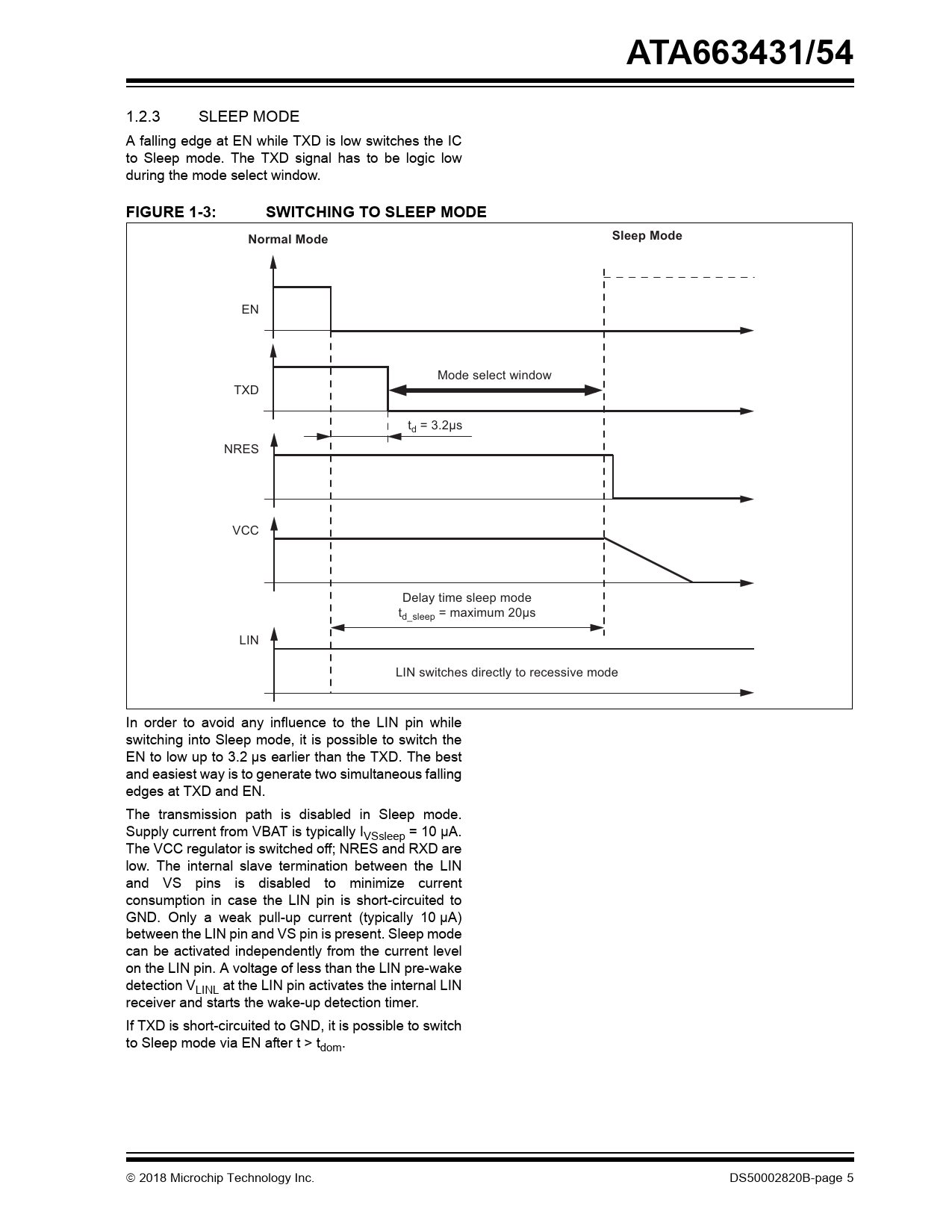

1.2.3 SLEEP MODE A falling edge at EN while TXD is low switches the IC to Sleep mode. The TXD signal has to be logic low during the mode select window.
FIGURE 1-3: SWITCHING TO SLEEP MODE Sleep Mode Normal Mode
EN Mode select window TXD td = 3.2μs NRES VCC Delay time sleep mode td_sleep = maximum 20μs LIN LIN switches directly to recessive mode In order to avoid any influence to the LIN pin while switching into Sleep mode, it is possible to switch the EN to low up to 3.2 μs earlier than the TXD. The best and easiest way is to generate two simultaneous falling edges at TXD and EN. The transmission path is disabled in Sleep mode. Supply current from VBAT is typically IVSsleep = 10 μA. The VCC regulator is switched off; NRES and RXD are low. The internal slave termination between the LIN and VS pins is disabled to minimize current consumption in case the LIN pin is short-circuited to GND. Only a weak pull-up current (typically 10 μA) between the LIN pin and VS pin is present. Sleep mode can be activated independently from the current level on the LIN pin. A voltage of less than the LIN pre-wake detection VLINL at the LIN pin activates the internal LIN receiver and starts the wake-up detection timer. If TXD is short-circuited to GND, it is possible to switch to Sleep mode via EN after t > tdom.  2018 Microchip Technology Inc.
