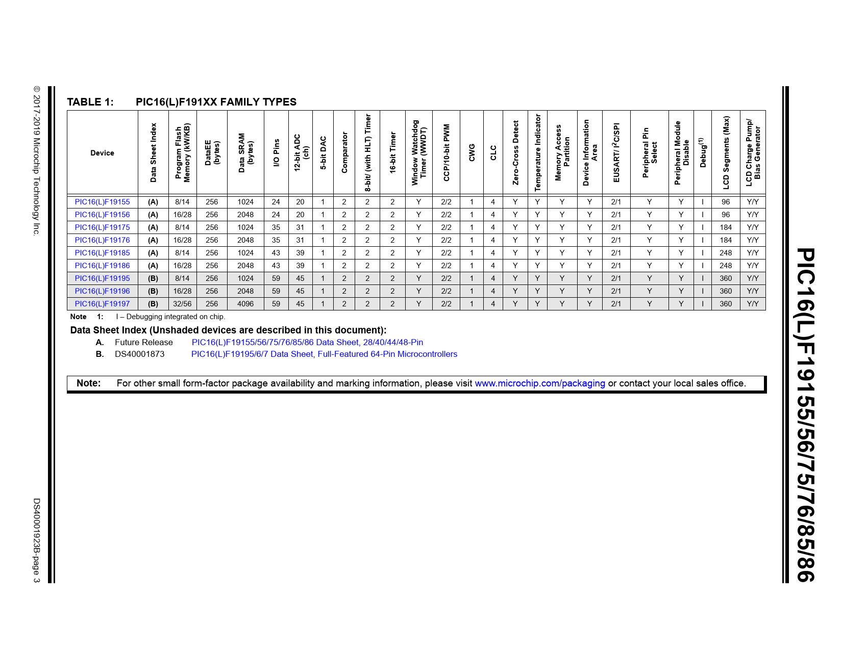

Pages / Page754 / 3 — TABLE 1:. PIC16(L)F191XX FAMILY TYPES. imer. ato. KB). ati. SPI. dule. …

PIC16F19155
PIC16F19156
PIC16F19175
PIC16F19176
PIC16F19185
PIC16F19186

PIC16(L)F19155
(A)
8/14 256 1024 24 20 1 2 2 2 Y 2/2 1 4 Y Y Y Y 2/1 Y Y I 96 Y/Y PIC16(L)F19156
(A)
16/28 256 2048 24 20 1 2 2 2 Y 2/2 1 4 Y Y Y Y 2/1 Y Y I 96 Y/Y c. PIC16(L)F19175
(A)
8/14 256 1024 35 31 1 2 2 2 Y 2/2 1 4 Y Y Y Y 2/1 Y Y I 184 Y/Y PIC16(L)F19176
(A)
16/28 256 2048 35 31 1 2 2 2 Y 2/2 1 4 Y Y Y Y 2/1 Y Y I 184 Y/Y

PIC16(L)F19185
(A)
8/14 256 1024 43 39 1 2 2 2 Y 2/2 1 4 Y Y Y Y 2/1 Y Y I 248 Y/Y PIC16(L)F19186
(A)
16/28 256 2048 43 39 1 2 2 2 Y 2/2 1 4 Y Y Y Y 2/1 Y Y I 248 Y/Y PIC16(L)F19195
(B)
8/14 256 1024 59 45 1 2 2 2 Y 2/2 1 4 Y Y Y Y 2/1 Y Y I 360 Y/Y PIC16(L)F19196
(B)
16/28 256 2048 59 45 1 2 2 2 Y 2/2 1 4 Y Y Y Y 2/1 Y Y I 360 Y/Y PIC16(L)F19197
(B)
32/56 256 4096 59 45 1 2 2 2 Y 2/2 1 4 Y Y Y Y 2/1 Y Y I 360 Y/Y
Note 1:
I – Debugging integrated on chip.
Data Sheet Index (Unshaded devices are described in this document): A.
Future Release PIC16(L)F19155/56/75/76/85/86 Data Sheet, 28/40/44/48-Pin
B.
DS40001873 PIC16(L)F19195/6/7 Data Sheet, Full-Featured 64-Pin Microcontrollers
