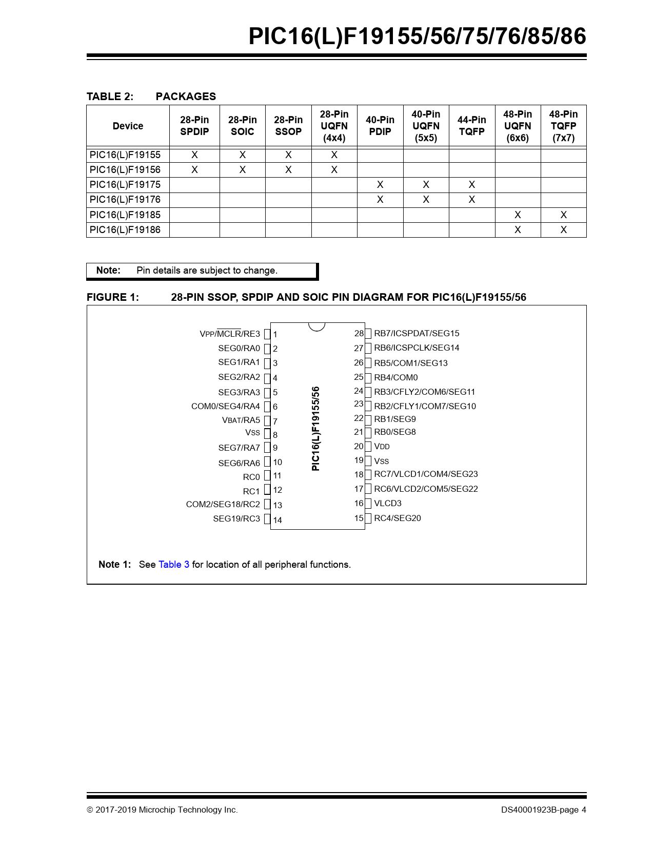

PIC16(L)F19155/56/75/76/85/86 TABLE 2: PACKAGES 28-Pin 40-Pin 48-Pin 48-Pin 28-Pin 28-Pin 28-Pin 40-Pin 44-Pin Device UQFN UQFN UQFN TQFP SPDIP SOIC SSOP PDIP TQFP (4x4) (5x5) (6x6) (7x7)
PIC16(L)F19155 X X X X PIC16(L)F19156 X X X X PIC16(L)F19175 X X X PIC16(L)F19176 X X X PIC16(L)F19185 X X PIC16(L)F19186 X X
Note:
Pin details are subject to change.
FIGURE 1: 28-PIN SSOP, SPDIP AND SOIC PIN DIAGRAM FOR PIC16(L)F19155/56
VPP/MCLR/RE3 1 28 RB7/ICSPDAT/SEG15 SEG0/RA0 2 27 RB6/ICSPCLK/SEG14 SEG1/RA1 3 26 RB5/COM1/SEG13 SEG2/RA2 4 25 RB4/COM0 SEG3/RA3 5 24 RB3/CFLY2/COM6/SEG11 COM0/SEG4/RA4 6 23
55/56
RB2/CFLY1/COM7/SEG10 VBAT/RA5 7 22 RB1/SEG9
191
VSS 8 21 RB0/SEG8 SEG7/RA7 9
6(L)F
20 VDD SEG6/RA6 10 19 VSS
PIC1
RC0 11 18 RC7/VLCD1/COM4/SEG23 RC1 12 17 RC6/VLCD2/COM5/SEG22 COM2/SEG18/RC2 13 16 VLCD3 SEG19/RC3 14 15 RC4/SEG20
Note 1:
