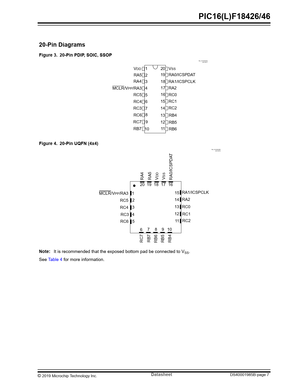

PIC16(L)F18426/46 20-Pin Diagrams Figure 3. 20-Pin PDIP, SOIC, SSOP
Rev. 00-000020A 6/21/2017 VDD 1 20 VSS RA5 2 19 RA0/ICSPDAT RA4 3 18 RA1/ICSPCLK MCLR/VPP/RA3 4 17 RA2 RC5 5 16 RC0 RC4 6 15 RC1 RC3 7 14 RC2 RC6 8 13 RB4 RC7 9 12 RB5 RB7 10 11 RB6
Figure 4. 20-Pin UQFN (4x4)
Rev. 00-000020B 6/21/2016 T DA P ICS 4 5 D S 0/ D S RA RA V V RA 20 19 18 17 16 MCLR/VPP/RA3 1 15 RA1/ICSPCLK RC5 2 14 RA2 RC4 3 13 RC0 RC3 4 12 RC1 RC6 5 11 RC2 6 7 8 9 10 7 7 6 5 4 RC RB RB RB RB
Note:
It is recommended that the exposed bottom pad be connected to VSS. See Table 4 for more information. © 2019 Microchip Technology Inc.
