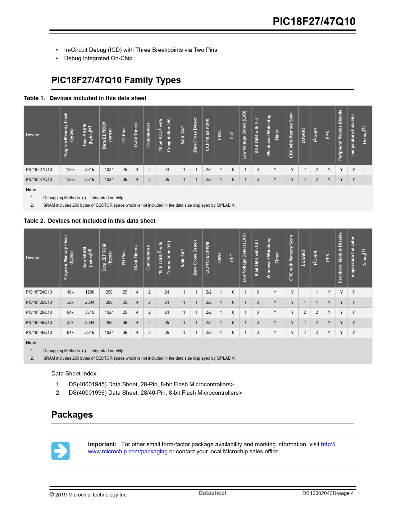

PIC18F27/47Q10. PIC18F27/47Q10 Family Types. Table 1.  Devices included in this data sheet. VD). (2). 2 with. atchdog. imers. (1). Device
PIC18F27/47Q10 PIC18F27/47Q10 Family Types Table 1.  Devices included in this data sheet VD) (2) 2 with atchdog imers (1) Device
PIC18F27/47Q10
• In-Circuit Debug (ICD) with Three Breakpoints via Two Pins • Debug Integrated On-Chip
PIC18F27/47Q10 Family Types Table 1.  Devices included in this data sheet VD) T (2) 2 with atchdog imers (1) Device imer (bytes) (bytes) CWG CLC I/O Pins T 2 C/SPI PPS EUSART I Data SRAM (bytes) 5-bit DAC Debug Data EEPROM 16-bit T Comparators oltage Detect (L 10-bit ADC Computation (ch) Zero-Cross Detect CCP/10-bit PWM 8-bit TMR with HL indowed W Program Memory Flash W Temperature Indicator Low V CRC with Memory Scan Peripheral Module Disable
PIC18F27Q10 128k 3615 1024 25 4 2 24 1 1 2/2 1 8 1 3 Y Y 2 2 Y Y Y I PIC18F47Q10 128k 3615 1024 36 4 2 35 1 1 2/2 1 8 1 3 Y Y 2 2 Y Y Y I
Note: 
1. Debugging Methods: (I) – Integrated on-chip. 2. SRAM includes 256 bytes of SECTOR space which is not included in the data size displayed by MPLAB X.
Table 2. Devices not included in this data sheet VD) T (2) 2 with atchdog imers (1) Device imer (bytes) (bytes) CWG CLC I/O Pins T 2 C/SPI PPS EUSART I Data SRAM (bytes) 5-bit DAC Debug Data EEPROM 16-bit T Comparators oltage Detect (L 10-bit ADC Computation (ch) Zero-Cross Detect CCP/10-bit PWM 8-bit TMR with HL indowed W Program Memory Flash W Temperature Indicator Low V CRC with Memory Scan Peripheral Module Disable
PIC18F24Q10 16k 1280 256 25 4 2 24 1 1 2/2 1 0 1 3 Y Y 1 1 Y Y Y I PIC18F25Q10 32k 2304 256 25 4 2 24 1 1 2/2 1 0 1 3 Y Y 1 1 Y Y Y I PIC18F26Q10 64k 3615 1024 25 4 2 24 1 1 2/2 1 8 1 3 Y Y 2 2 Y Y Y I PIC18F45Q10 32k 2304 256 36 4 2 35 1 1 2/2 1 8 1 3 Y Y 2 2 Y Y Y I PIC18F46Q10 64k 3615 1024 36 4 2 35 1 1 2/2 1 8 1 3 Y Y 2 2 Y Y Y I
Note: 
1. Debugging Methods: (I) – Integrated on-chip. 2. SRAM includes 256 bytes of SECTOR space which is not included in the data size displayed by MPLAB X. Data Sheet Index: 1. DS(40001945) Data Sheet, 28-Pin, 8-bit Flash Microcontrollers> 2. DS(40001996) Data Sheet, 28/40-Pin, 8-bit Flash Microcontrollers>
Packages Important: 
For other small form-factor package availability and marking information, visit http:// www.microchip.com/packaging or contact your local Microchip sales office. © 2019 Microchip Technology Inc.
