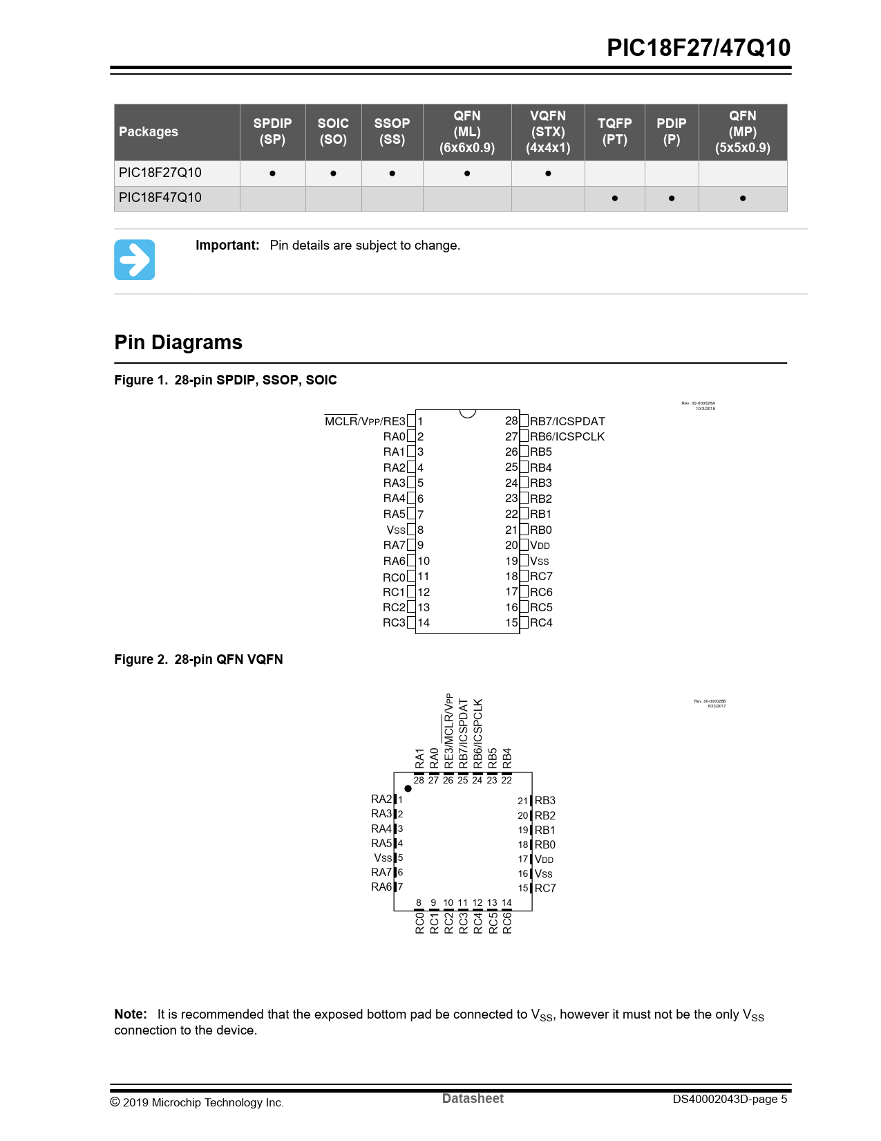

PIC18F27Q10 ● ● ● ● ● PIC18F47Q10 ● ● ●
Important: 
Pin details are subject to change. Filename: 00-000028A.vsd Title: 28-pin DIP Last Edit: 10/3/2018 First Used: N/A
Pin Diagrams
Notes: Generic 28-pin dual in-line diagram
Figure 1. 28-pin SPDIP, SSOP, SOIC
Rev. 00-000028A 10/3/2018 MCLR/VPP/RE3 1 28 RB7/ICSPDAT RA0 2 27 RB6/ICSPCLK RA1 3 26 RB5 RA2 4 25 RB4 RA3 5 24 RB3 RA4 6 23 RB2 RA5 7 22 RB1 VSS 8 21 RB0 RA7 9 20 VDD RA6 10 19 VSS RC0 11 18 RC7 RC1 12 17 RC6 RC2 13 16 RC5 RC3 14 15 RC4
Figure 2. 28-pin QFN VQFN
P Rev. 00-000028B P T K 6/23/2017 L /V R DA C L P P C S /M /ICS /IC 1 0 3 7 6 5 4 A A E B B B B R R R R R R R 28 27 26 25 24 23 22 RA2 1 21 RB3 RA3 2 20 RB2 RA4 3 19 RB1 RA5 4 18 RB0 VSS 5 17 VDD RA7 6 16 VSS RA6 7 15 RC7 8 9 10 11 12 13 14 0 1 2 3 4 5 6 C C C C C C C R R R R R R R
Note: 
It is recommended that the exposed bottom pad be connected to VSS, however it must not be the only VSS connection to the device. © 2019 Microchip Technology Inc.
