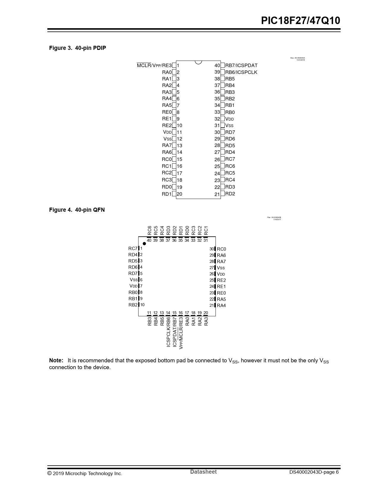

PIC18F27/47Q10. Figure 3. 40-pin PDIP. Figure 4. 40-pin QFN. Note: . Datasheet
Filename: 00-000040A.vsd Title: 40-pin DIP Last Edit: 10/3/2018
PIC18F27/47Q10
First Used: N/A Notes: Generic 40-pin dual in-line diagram
Rev. 00-000040A 10/3/2018 MCLR/VPP/RE3 1 40 RB7/ICSPDAT RA0 2 39 RB6/ICSPCLK RA1 3 38 RB5 RA2 4 37 RB4 RA3 5 36 RB3 RA4 6 35 RB2 RA5 7 34 RB1 RE0 8 33 RB0 RE1 9 32 VDD RE2 10 31 VSS VDD 11 30 RD7 VSS 12 29 RD6 RA7 13 28 RD5 RA6 14 27 RD4 RC0 15 26 RC7 RC1 16 25 RC6 Filename: 00-000040B.vsd RC2 Title: 40-pin QFN 17 24 RC5 Last Edit: 11/6/2017 RC3 18 23 RC4 First Used: N/A RD0 19 22 RD3 Notes: Generic 40-pin QFN diagram RD1 20 21 RD2
Rev. 00-000040B 11/6/2017 6 5 4 3 2 1 0 3 2 1 C C C D D D D C C C R R R R R R R R R R 40 39 38 37 36 35 34 33 32 31 RC7 1 30 RC0 RD4 2 29 RA6 RD5 3 28 RA7 RD6 4 27 VSS RD7 5 26 VDD VSS 6 25 RE2 VDD 7 24 RE1 RB0 8 23 RE0 RB1 9 22 RA5 RB2 10 21 RA4 11 12 13 14 15 16 17 18 19 20 3 4 5 6 7 3 0 1 2 3 B B B B B E A A A A R R R R R R R /R /R /R T LK A LR C D C P P S /M S P IC P IC V
Note:
It is recommended that the exposed bottom pad be connected to VSS, however it must not be the only VSS connection to the device. © 2019 Microchip Technology Inc.
