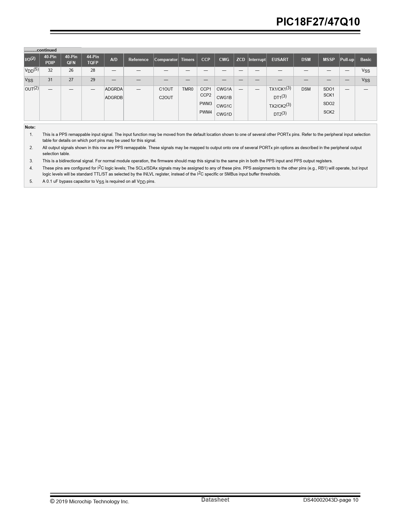

PIC18F27/47Q10. ...continued. 40-Pin. 44-Pin. I/O(2). A/D. Reference. Comparator Timers. CCP. CWG. ZCD Interrupt. EUSART. DSM. MSSP. Pull-up. Basic
PIC18F27/47Q10 ...continued 40-Pin 44-Pin I/O(2) A/D Reference Comparator Timers CCP CWG ZCD Interrupt EUSART DSM MSSP Pull-up Basic
PIC18F27/47Q10 ...continued 40-Pin 44-Pin I/O(2) 40-Pin A/D Reference Comparator Timers CCP CWG ZCD Interrupt EUSART DSM MSSP Pull-up Basic PDIP QFN TQFP
VDD(5) 32 26 28 — — — — — — — — — — — — VSS VSS 31 27 29 — — — — — — — — — — — — VSS OUT(2) — — — ADGRDA — C1OUT TMR0 CCP1 CWG1A — — TX1/CK1(3) DSM SDO1 — — CCP2 SCK1 ADGRDB C2OUT CWG1B DT1(3) PWM3 SDO2 CWG1C TX2/CK2(3) PWM4 SCK2 CWG1D DT2(3)
Note: 
1. This is a PPS remappable input signal. The input function may be moved from the default location shown to one of several other PORTx pins. Refer to the peripheral input selection table for details on which port pins may be used for this signal. 2. All output signals shown in this row are PPS remappable. These signals may be mapped to output onto one of several PORTx pin options as described in the peripheral output selection table. 3. This is a bidirectional signal. For normal module operation, the firmware should map this signal to the same pin in both the PPS input and PPS output registers. 4. These pins are configured for I2C logic levels; The SCLx/SDAx signals may be assigned to any of these pins. PPS assignments to the other pins (e.g., RB1) will operate, but input logic levels will be standard TTL/ST as selected by the INLVL register, instead of the I2C specific or SMBus input buffer thresholds. 5. A 0.1 uF bypass capacitor to VSS is required on all VDD pins. © 2019 Microchip Technology Inc.
