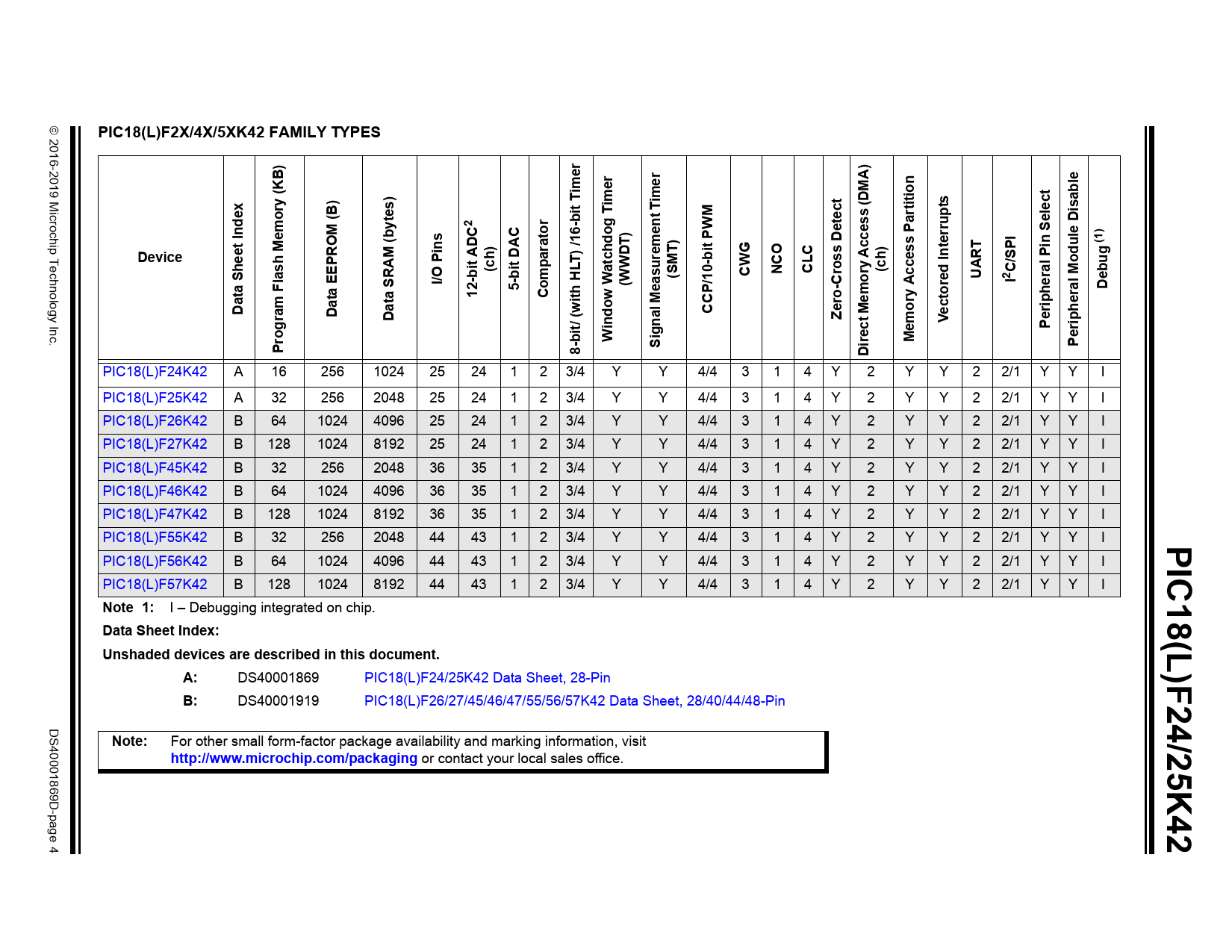

PIC18(L)F2X/4X/5XK42 FAMILY TYPES. (KB). ime. t T. rtition. dex. Select. 6-bi. (by. tor. rru. le Disab. (1). ins. Device. eet. PROM (. ara. Access (DMA)

PIC18(L)F24K42 A 16 256 1024 25 24 1 2 3/4 Y Y 4/4 3 1 4 Y 2 Y Y 2 2/1 Y Y I PIC18(L)F25K42 A 32 256 2048 25 24 1 2 3/4 Y Y 4/4 3 1 4 Y 2 Y Y 2 2/1 Y Y I PIC18(L)F26K42 B 64 1024 4096 25 24 1 2 3/4 Y Y 4/4 3 1 4 Y 2 Y Y 2 2/1 Y Y I PIC18(L)F27K42 B 128 1024 8192 25 24 1 2 3/4 Y Y 4/4 3 1 4 Y 2 Y Y 2 2/1 Y Y I PIC18(L)F45K42 B 32 256 2048 36 35 1 2 3/4 Y Y 4/4 3 1 4 Y 2 Y Y 2 2/1 Y Y I PIC18(L)F46K42 B 64 1024 4096 36 35 1 2 3/4 Y Y 4/4 3 1 4 Y 2 Y Y 2 2/1 Y Y I PIC18(L)F47K42 B 128 1024 8192 36 35 1 2 3/4 Y Y 4/4 3 1 4 Y 2 Y Y 2 2/1 Y Y I PIC18(L)F55K42 B 32 256 2048 44 43 1 2 3/4 Y Y 4/4 3 1 4 Y 2 Y Y 2 2/1 Y Y I
PIC18(L)F24/25K42
PIC18(L)F56K42 B 64 1024 4096 44 43 1 2 3/4 Y Y 4/4 3 1 4 Y 2 Y Y 2 2/1 Y Y I PIC18(L)F57K42 B 128 1024 8192 44 43 1 2 3/4 Y Y 4/4 3 1 4 Y 2 Y Y 2 2/1 Y Y I
Note 1:
I – Debugging integrated on chip.
Data Sheet Index: Unshaded devices are described in this document. A:
DS40001869 PIC18(L)F24/25K42 Data Sheet, 28-Pin
B:
DS40001919 PIC18(L)F26/27/45/46/47/55/56/57K42 Data Sheet, 28/40/44/48-Pin DS400
Note:
For other small form-factor package availability and marking information, visit 01869D-
http://www.microchip.com/packaging
