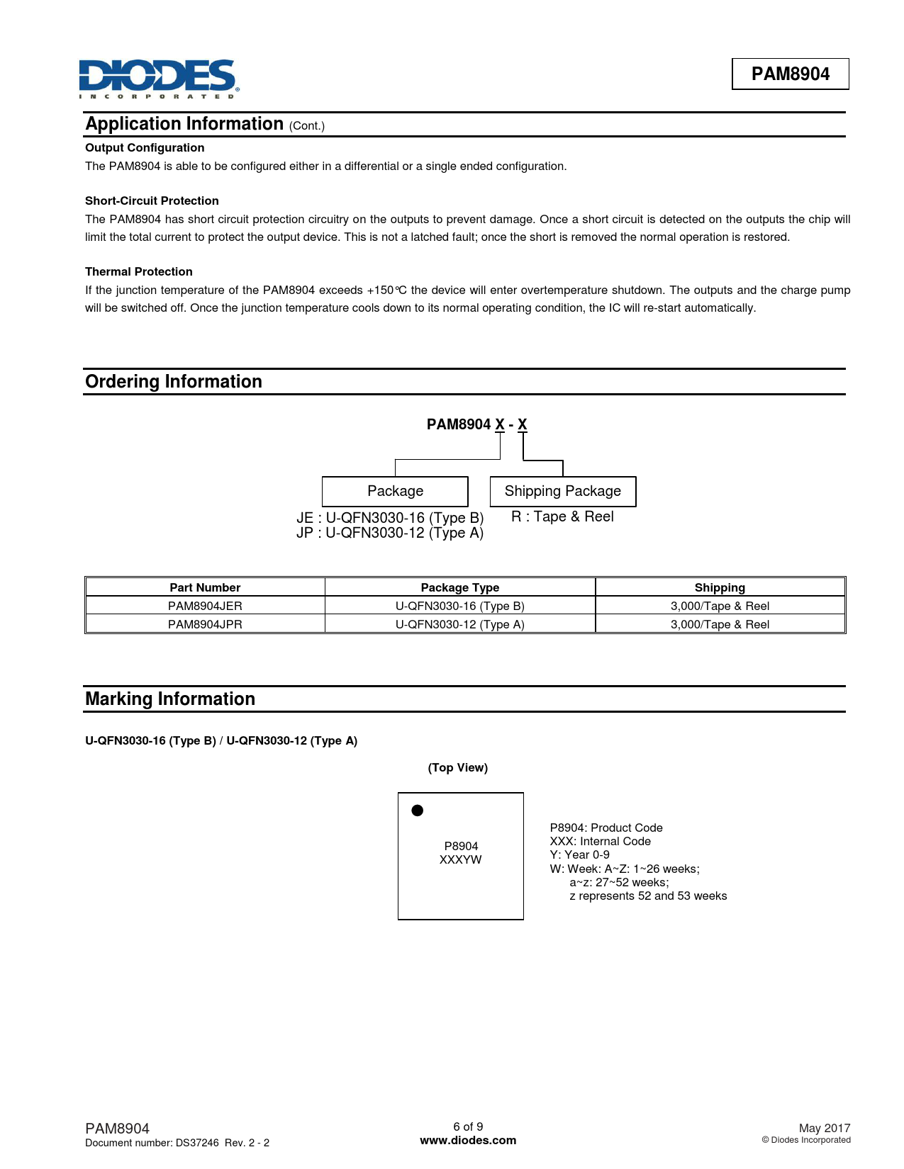

PAM8904. Application Information. Output Configuration. Short-Circuit Protection. Thermal Protection. Ordering Information
PAM8904 Application Information
(Cont.)
The PAM8904 is able to be configured either in a differential or a single ended configuration.
The PAM8904 has short circuit protection circuitry on the outputs to prevent damage. Once a short circuit is detected on the outputs the chip will limit the total current to protect the output device. This is not a latched fault; once the short is removed the normal operation is restored.
Thermal Protection
If the junction temperature of the PAM8904 exceeds +150°C the device will enter overtemperature shutdown. The outputs and the charge pump will be switched off. Once the junction temperature cools down to its normal operating condition, the IC will re-start automatically.
Ordering Information PAM8904 X - X
Package Shipping Package JE : U-QFN3030-16 (Type B) R : Tape & Reel JP : U-QFN3030-12 (Type A)
Part Number Package Type Shipping
PAM8904JER U-QFN3030-16 (Type B) 3,000/Tape & Reel PAM8904JPR U-QFN3030-12 (Type A) 3,000/Tape & Reel
Marking Information U-QFN3030-16 (Type B) / U-QFN3030-12 (Type A) (Top View)
P8904: Product Code XXX: Internal Code P8904 Y: Year 0-9 XXXYW W: Week: A~Z: 1~26 weeks; a~z: 27~52 weeks; z represents 52 and 53 weeks PAM8904 6 of 9 May 2017 Document number: DS37246 Rev. 2 - 2
