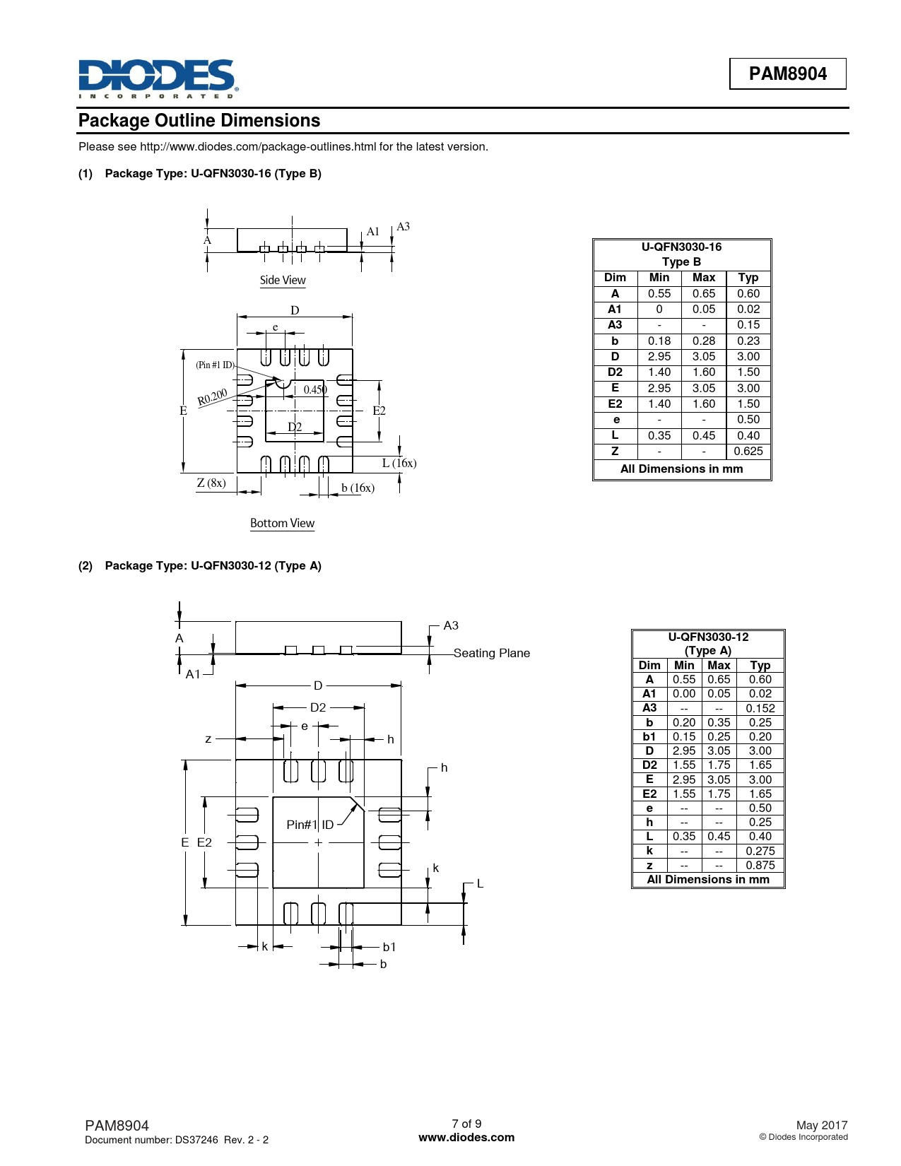

PAM8904. Package Outline Dimensions. (1) Package Type: U-QFN3030-16 (Type B). U-QFN3030-16. Type B. Dim. Min. Max. Typ
PAM8904 Package Outline Dimensions
Please see http://www.diodes.com/package-outlines.html for the latest version.
A3 A1 A
U-QFN3030-16 Type B
Side View
Dim Min Max Typ A
0.55 0.65 0.60 D
A1
0 0.05 0.02 e
A3
- - 0.15
b
0.18 0.28 0.23
D
2.95 3.05 3.00 (Pin #1 ID)
D2
1.40 1.60 1.50 0.450
E
2.95 3.05 3.00 R0.200
E2
1.40 1.60 1.50 E E2
e
- - 0.50 D2
L
0.35 0.45 0.40
Z
- - 0.625 L (16x)
All Dimensions in mm
Z (8x) b (16x) Bottom View
(2) Package Type: U-QFN3030-12 (Type A)
A3 A
U-QFN3030-12
Seating Plane
(Type A)
A1
Dim Min Max Typ
D
A
0.55 0.65 0.60
A1
0.00 0.05 0.02 D2
A3
-- -- 0.152 e
b
0.20 0.35 0.25 z h
b1
0.15 0.25 0.20
D
2.95 3.05 3.00 h
D2
1.55 1.75 1.65
E
2.95 3.05 3.00
E2
1.55 1.75 1.65
e
-- -- 0.50 Pin#1 ID
h
-- -- 0.25 E E2
L
0.35 0.45 0.40
k
-- -- 0.275 k
z
-- -- 0.875 L
k b1 b PAM8904 7 of 9 May 2017 Document number: DS37246 Rev. 2 - 2
