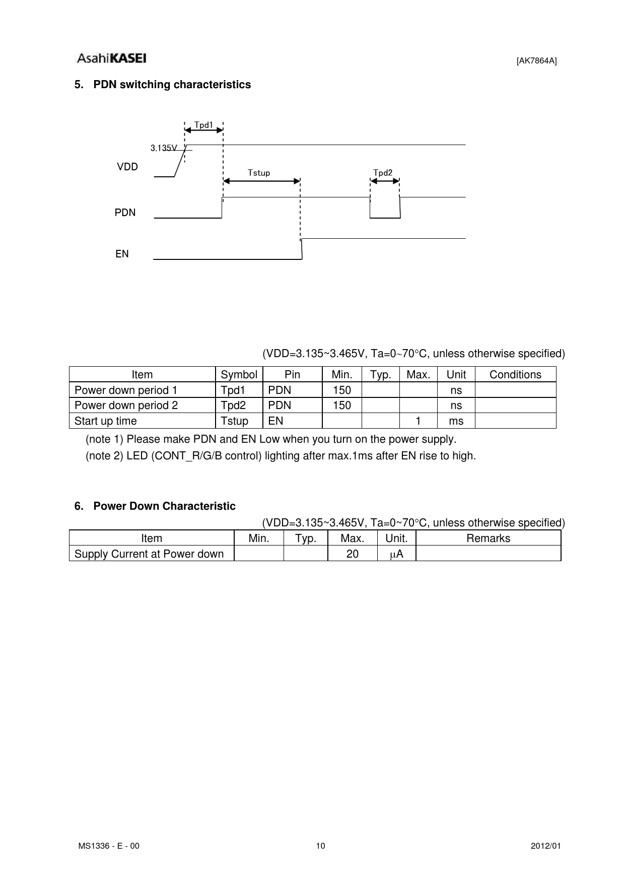

5. PDN switching characteristics
Tpd1 3.135V VDD Tstup Tpd2 PDN EN
(VDD=3.135~3.465V, Ta=070C, unless otherwise specified) Item Symbol Pin Min. Typ. Max. Unit Conditions Power down period 1 Tpd1 PDN 150 ns Power down period 2 Tpd2 PDN 150 ns Start up time Tstup EN 1 ms (note 1) Please make PDN and EN Low when you turn on the power supply. (note 2) LED (CONT_R/G/B control) lighting after max.1ms after EN rise to high.
6. Power Down Characteristic
(VDD=3.135~3.465V, Ta=0~70C, unless otherwise specified) Item Min. Typ. Max. Unit. Remarks Supply Current at Power down 20 A
