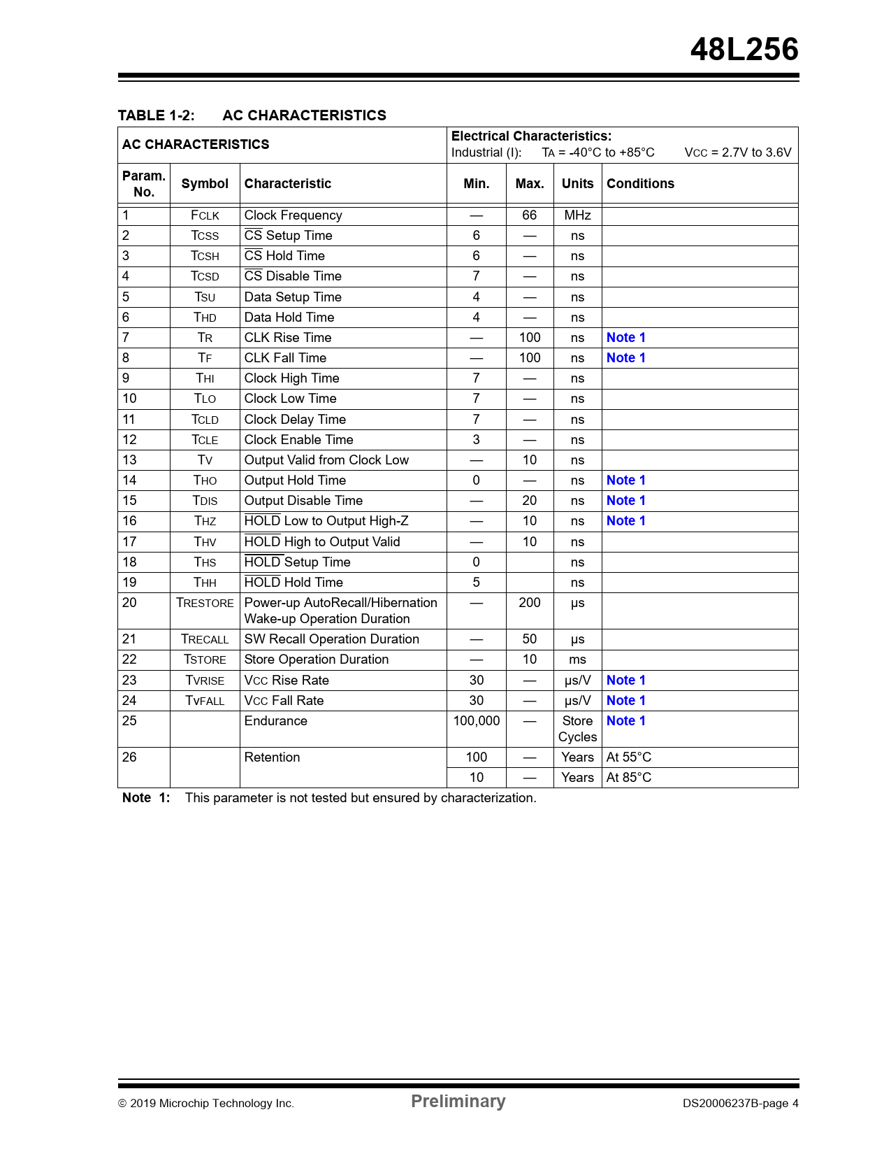

48L256. TABLE 1-2:. AC CHARACTERISTICS. Electrical Characteristics:. Param. Symbol. Characteristic. Min. Max. Units Conditions. No. Note 1
48L256 TABLE 1-2: AC CHARACTERISTICS Electrical Characteristics: Param Symbol Characteristic Min Max Units Conditions No Note 1
link to page 4 link to page 4 link to page 4 link to page 4 link to page 4 link to page 4 link to page 4 link to page 4
48L256 TABLE 1-2: AC CHARACTERISTICS Electrical Characteristics: AC CHARACTERISTICS
Industrial (I): TA = -40°C to +85°C VCC = 2.7V to 3.6V
Param. Symbol Characteristic Min. Max. Units Conditions No.
1 FCLK Clock Frequency — 66 MHz 2 TCSS CS Setup Time 6 — ns 3 TCSH CS Hold Time 6 — ns 4 TCSD CS Disable Time 7 — ns 5 TSU Data Setup Time 4 — ns 6 THD Data Hold Time 4 — ns 7 TR CLK Rise Time — 100 ns
Note 1
8 TF CLK Fall Time — 100 ns
Note 1
9 THI Clock High Time 7 — ns 10 TLO Clock Low Time 7 — ns 11 TCLD Clock Delay Time 7 — ns 12 TCLE Clock Enable Time 3 — ns 13 TV Output Valid from Clock Low — 10 ns 14 THO Output Hold Time 0 — ns
Note 1
15 TDIS Output Disable Time — 20 ns
Note 1
16 THZ HOLD Low to Output High-Z — 10 ns
Note 1
17 THV HOLD High to Output Valid — 10 ns 18 THS HOLD Setup Time 0 ns 19 THH HOLD Hold Time 5 ns 20 TRESTORE Power-up AutoRecal /Hibernation — 200 μs Wake-up Operation Duration 21 TRECALL SW Recall Operation Duration — 50 μs 22 TSTORE Store Operation Duration — 10 ms 23 TVRISE VCC Rise Rate 30 — μs/V
Note 1
24 TvFALL VCC Fall Rate 30 — μs/V
Note 1
25 Endurance 100,000 — Store
Note 1
Cycles 26 Retention 100 — Years At 55°C 10 — Years At 85°C
