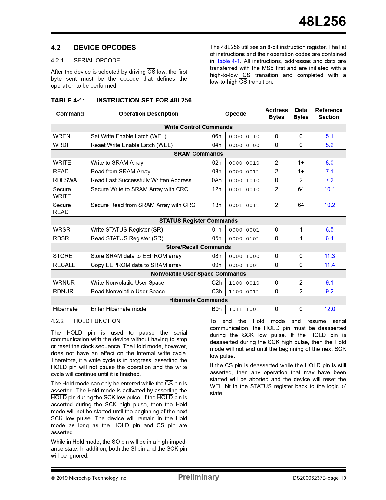

48L256 4.2 DEVICE OPCODES
The 48L256 utilizes an 8-bit instruction register. The list of instructions and their operation codes are contained 4.2.1 SERIAL OPCODE in Table 4-1. All instructions, addresses and data are transferred with the MSb first and are initiated with a After the device is selected by driving CS low, the first high-to-low CS transition and completed with a byte sent must be the opcode that defines the low-to-high CS transition. operation to be performed.
TABLE 4-1: INSTRUCTION SET FOR 48L256 Address Data Reference Command Operation Description Opcode Bytes Bytes Section Write Control Commands
WREN Set Write Enable Latch (WEL) 06h 0000 0110 0 0 5.1 WRDI Reset Write Enable Latch (WEL) 04h 0000 0100 0 0 5.2
SRAM Commands
WRITE Write to SRAM Array 02h 0000 0010 2 1+ 8.0 READ Read from SRAM Array 03h 0000 0011 2 1+ 7.1 RDLSWA Read Last Successfully Written Address 0Ah 0000 1010 0 2 7.2 Secure Secure Write to SRAM Array with CRC 12h 0001 0010 2 64 10.1 WRITE Secure Secure Read from SRAM Array with CRC 13h 0001 0011 2 64 10.2 READ
STATUS Register Commands
WRSR Write STATUS Register (SR) 01h 0000 0001 0 1 6.5 RDSR Read STATUS Register (SR) 05h 0000 0101 0 1 6.4
Store/Recall Commands
STORE Store SRAM data to EEPROM array 08h 0000 1000 0 0 11.3 RECALL Copy EEPROM data to SRAM array 09h 0000 1001 0 0 11.4
Nonvolatile User Space Commands
WRNUR Write Nonvolatile User Space C2h 1100 0010 0 2 9.1 RDNUR Read Nonvolatile User Space C3h 1100 0011 0 2 9.2
Hibernate Commands
Hibernate Enter Hibernate mode B9h 1011 1001 0 0 12.0 4.2.2 HOLD FUNCTION To end the Hold mode and resume serial communication, the HOLD pin must be deasserted The HOLD pin is used to pause the serial during the SCK low pulse. If the HOLD pin is communication with the device without having to stop deasserted during the SCK high pulse, then the Hold or reset the clock sequence. The Hold mode, however, mode will not end until the beginning of the next SCK does not have an effect on the internal write cycle. low pulse. Therefore, if a write cycle is in progress, asserting the HOLD pin will not pause the operation and the write If the CS pin is deasserted while the HOLD pin is still cycle will continue until it is finished. asserted, then any operation that may have been started will be aborted and the device will reset the The Hold mode can only be entered while the CS pin is WEL bit in the STATUS register back to the logic ‘0’ asserted. The Hold mode is activated by asserting the state. HOLD pin during the SCK low pulse. If the HOLD pin is asserted during the SCK high pulse, then the Hold mode wil not be started until the beginning of the next SCK low pulse. The device wil remain in the Hold mode as long as the HOLD pin and CS pin are asserted. While in Hold mode, the SO pin will be in a high-imped- ance state. In addition, both the SI pin and the SCK pin will be ignored.  2019 Microchip Technology Inc.
