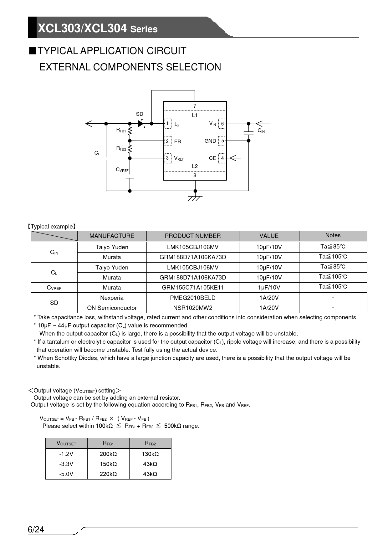

Pages / Page24 / 6 — XCL303/XCL304 Series
File Format / SizePDF / 791 Kb
■TYPICAL APPLICATION CIRCUIT EXTERNAL COMPONENTS SELECTION 7 SD L1 1 L VIN 6 x RFB1 CIN 2 GND 5 FB RFB2 CL 3 VREF CE 4 L2 CVREF 8 【Typical example】 MANUFACTURE PRODUCT NUMBER VALUE Notes Taiyo Yuden LMK105CBJ106MV 10μF/10V Ta≦85℃ CIN Murata GRM188D71A106KA73D 10μF/10V Ta≦105℃ Taiyo Yuden LMK105CBJ106MV 10μF/10V Ta≦85℃ CL Murata GRM188D71A106KA73D 10μF/10V Ta≦105℃ CVREF Murata GRM155C71A105KE11 1μF/10V Ta≦105℃ Nexperia PMEG2010BELD 1A/20V - SD ON Semiconductor NSR1020MW2 1A/20V - * Take capacitance loss, withstand voltage, rated current and other conditions into consideration when selecting components. * 10μF ~ 44μF output capacitor (CL) value is recommended. When the output capacitor (CL) is large, there is a possibility that the output voltage will be unstable. * If a tantalum or electrolytic capacitor is used for the output capacitor (CL), ripple voltage will increase, and there is a possibility that operation will become unstable. Test fully using the actual device. * When Schottky Diodes, which have a large junction capacity are used, there is a possibility that the output voltage will be unstable. <Output voltage (VOUTSET) setting> Output voltage can be set by adding an external resistor. Output voltage is set by the following equation according to RFB1, RFB2, VFB and VREF. VOUTSET = VFB - RFB1 / RFB2 × ( VREF - VFB ) Please select within 100kΩ ≦ RFB1 + RFB2 ≦ 500kΩ range. VOUTSET RFB1 RFB2 -1.2V 200kΩ 130kΩ -3.3V 150kΩ 43kΩ -5.0V 220kΩ 43kΩ 6/24
