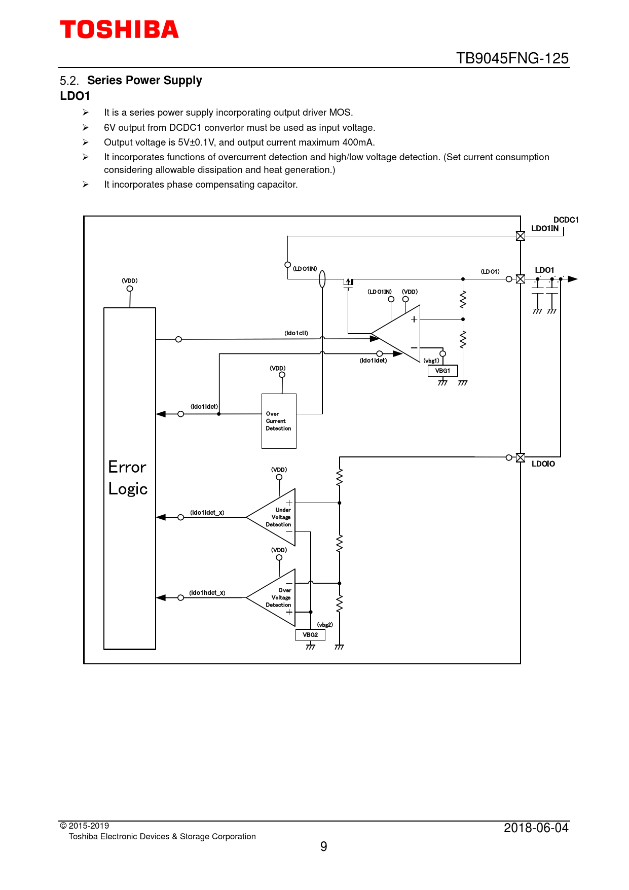

TB9045FNG-110
Series Power Supply LDO1
It is a series power supply incorporating output driver MOS. 6V output from DCDC1 convertor must be used as input voltage. Output voltage is 5V±0.1V, and output current maximum 400mA. It incorporates functions of overcurrent detection and high/low voltage detection. (Set current consumption considering allowable dissipation and heat generation.) It incorporates phase compensating capacitor. DCDC1 LDO1IN (LD O1IN) (LD O1) LDO1 (VDD) (LD O1IN) (VDD) (
ldo1ctl
ldo1idet
) (vbg1) (VDD) VBG1 (
ldo1idet
) Over Current Detection Error LDOIO (VDD) Logic Under (
ldo1ldet_x
) Voltage Detection (VDD) Over (
ldo1hdet_x
) Voltage Detection (vbg2) VBG2 © 2015-2019 2018-06-04 Toshiba Electronic Devices & Storage Corporation 9
