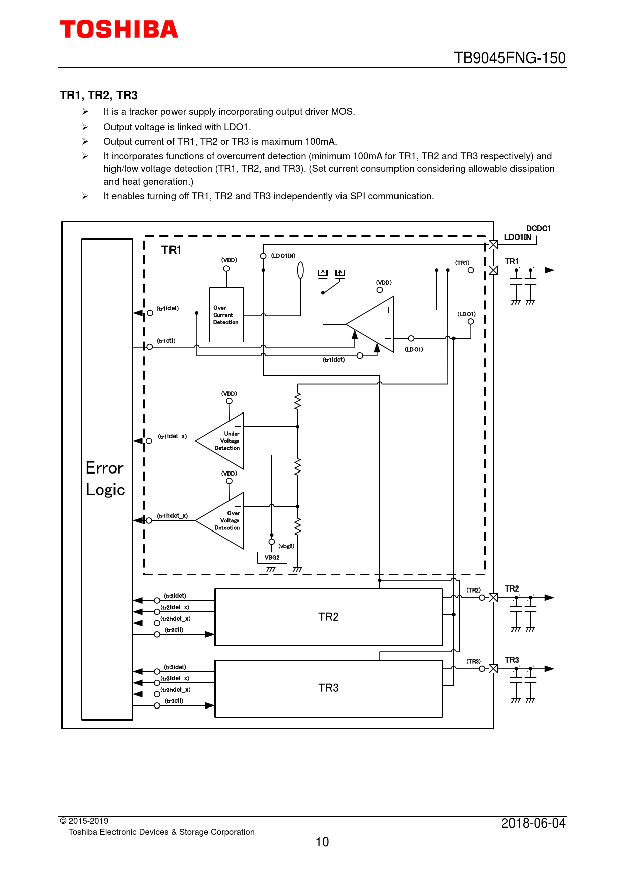

Pages / Page45 / 10 — TR1, TR2, TR3. idet. ctl. ldet_x. hdet_x. det_x
File Format / SizePDF / 767 Kb
TR1, TR2, TR3 idet ctl ldet_x hdet_x det_x
TB9045FNG-110
TR1, TR2, TR3
 It is a tracker power supply incorporating output driver MOS.  Output voltage is linked with LDO1.  Output current of TR1, TR2 or TR3 is maximum 100mA.  It incorporates functions of overcurrent detection (minimum 100mA for TR1, TR2 and TR3 respectively) and high/low voltage detection (TR1, TR2, and TR3). (Set current consumption considering allowable dissipation and heat generation.)  It enables turning off TR1, TR2 and TR3 independently via SPI communication. DCDC1 LDO1IN TR1 (LD O1IN) (VDD) (TR1) TR1 (VDD) (tr1 Over
idet
) Current (LD O1) Detection (tr1
ctl
) (LD O1) (tr1
idet
) (VDD) Under (tr1
ldet_x
) Voltage Detection Error (VDD) Logic Over (tr1
hdet_x
) Voltage Detection (vbg2) VBG2 (TR2) TR2 (tr2
idet
) (tr2
ldet_x
) (tr2h
det_x
) TR2 (tr2
ctl
) (TR3) TR3 (tr3
idet
) (tr3
ldet_x
) (tr3h
det_x
) TR3 (tr3
ctl
) © 2015-2019 2018-06-04 Toshiba Electronic Devices & Storage Corporation 10
