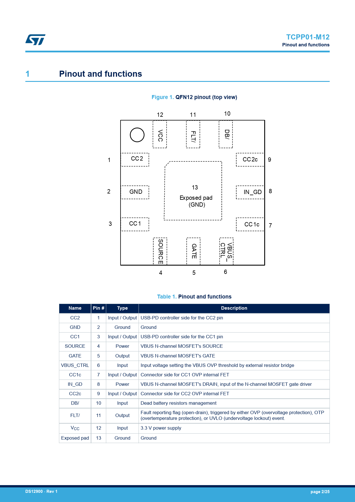

TCPP01-M12. Pinout and functions. Figure 1. QFN12 pinout (top view). Table 1. Pinout and functions. Name. Pin #. Type. Description
TCPP01-M12 Pinout and functions Figure 1 QFN12 pinout (top view) Table 1 Pinout and functions Name Pin # Type Description
TCPP01-M12 Pinout and functions 1 Pinout and functions Figure 1. QFN12 pinout (top view)
12 11 10 VC D F L B/ C T/ CC2 1 CC2c 9 13 2 GND IN_GD 8 Exposed pad (GND) 3 CC1 CC1c 7 SOURC GAT C VBU TR E L S_ E 4 5 6
Table 1. Pinout and functions Name Pin # Type Description
CC2 1 Input / Output USB-PD controller side for the CC2 pin GND 2 Ground Ground CC1 3 Input / Output USB-PD controller side for the CC1 pin SOURCE 4 Power VBUS N-channel MOSFET's SOURCE GATE 5 Output VBUS N-channel MOSFET's GATE VBUS_CTRL 6 Input Input voltage setting the VBUS OVP threshold by external resistor bridge CC1c 7 Input / Output Connector side for CC1 OVP internal FET IN_GD 8 Power VBUS N-channel MOSFET's DRAIN, input of the N-channel MOSFET gate driver CC2c 9 Input / Output Connector side for CC2 OVP internal FET DB/ 10 Input Dead battery resistors management Fault reporting flag (open-drain), triggered by either OVP (overvoltage protection), OTP FLT/ 11 Output (overtemperature protection), or UVLO (undervoltage lockout) event. VCC 12 Input 3.3 V power supply Exposed pad 13 Ground Ground
