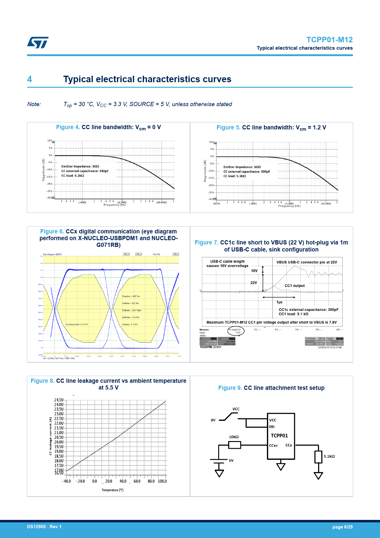

Pages / Page25 / 6 — TCPP01-M12. Typical electrical characteristics curves. Figure 4. CC line …
File Format / SizePDF / 2.5 Mb
TCPP01-M12. Typical electrical characteristics curves. Figure 4. CC line bandwidth: Vcm = 0 V
TCPP01-M12 Typical electrical characteristics curves Figure 4 CC line bandwidth: Vcm = 0 V
TCPP01-M12 Typical electrical characteristics curves 4 Typical electrical characteristics curves
Note: Top = 30 °C, VCC = 3.3 V, SOURCE = 5 V, unless otherwise stated
Figure 4. CC line bandwidth: Vcm = 0 V Figure 5. CC line bandwidth: Vcm = 1.2 V Figure 6. CCx digital communication (eye diagram performed on X-NUCLEO-USBPDM1 and NUCLEO- G071RB) Figure 7. CC1c line short to VBUS (22 V) hot-plug via 1m of USB-C cable, sink configuration Figure 8. CC line leakage current vs ambient temperature at 5.5 V Figure 9. CC line attachment test setup DS12900
