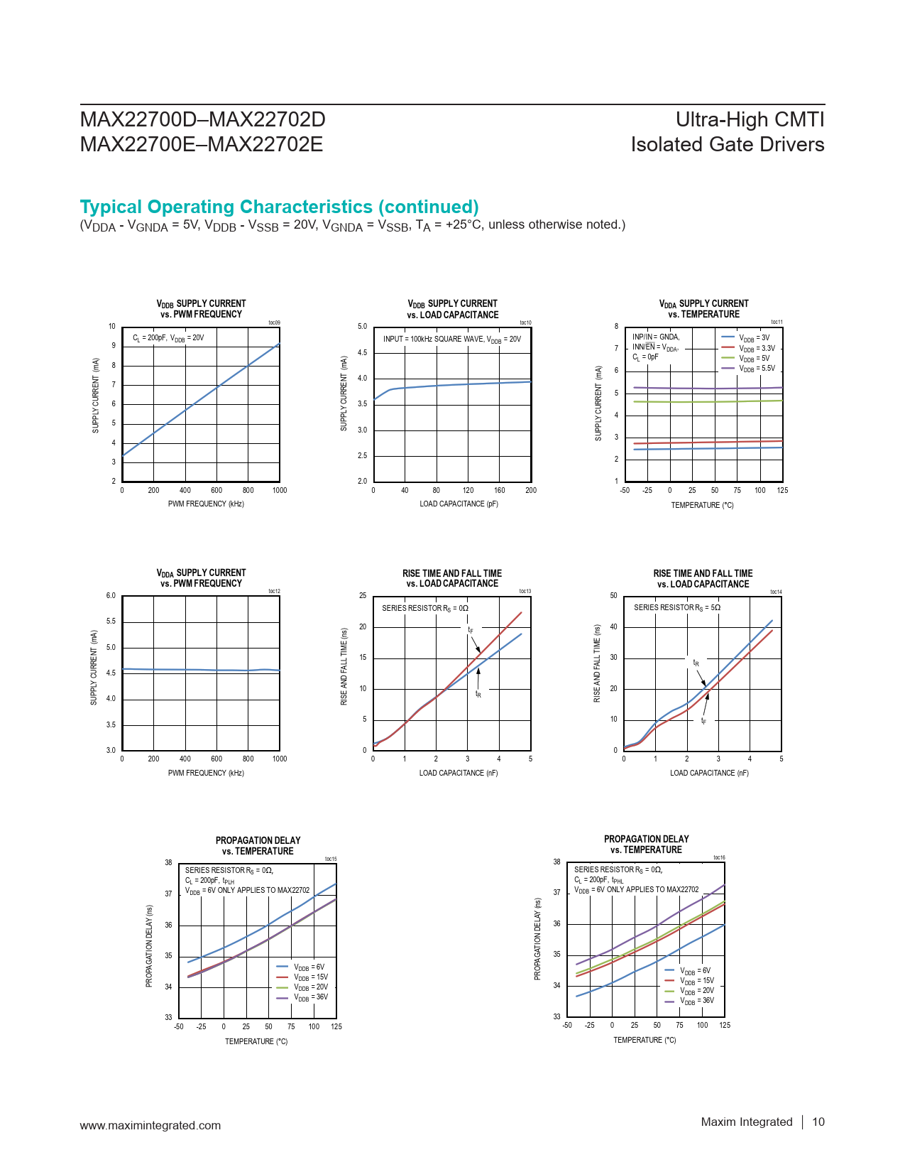

Pages / Page30 / 10 — Typical Operating Characteristics (continued). VDDB SUPPLY CURRENT. VDDA …
Typical Operating Characteristics (continued). VDDB SUPPLY CURRENT. VDDA SUPPLY CURRENT. vs. PWM FREQUENCY
Typical Operating Characteristics (continued) VDDB SUPPLY CURRENT VDDA SUPPLY CURRENT vs PWM FREQUENCY
MAX22700D–MAX22702D Ultra-High CMTI MAX22700E–MAX22702E Isolated Gate Drivers
(VDDA - VGNDA = 5V, VDDB - VSSB = 20V, VGNDA = VSSB, TA = +25°C, unless otherwise noted.)
VDDB SUPPLY CURRENT VDDB SUPPLY CURRENT VDDA SUPPLY CURRENT vs. PWM FREQUENCY vs. LOAD CAPACITANCE vs. TEMPERATURE
10 toc09 5.0 toc10 8 toc11 C INP/IN = GNDA, VDDA = 3V L = 200pF, VDDB = 20V INPUT = 100kHz SQUARE WAVE, V VDDB = 3V 9 DDB = 20V INN/EN = V VD V DA = 3.3V 4.5 7 DDA, DDB = 3. C VD V DA = 5V A) A) L = 0pF 8 DDB = 5V A) 6 VD V DA = 5.5V DDB = 5. 4.0 7 5 URRENT (m URRENT (m 6 3.5 URRENT (m 4 5 SUPPLY C SUPPLY C 3.0 SUPPLY C 3 4 2.5 3 2 2 2.0 1 0 200 400 600 800 1000 0 40 80 120 160 200 -50 -25 0 25 50 75 100 125 PWM FREQUENCY (kHz) LOAD CAPACITANCE (pF) TEMPERATURE (°C)
VDDA SUPPLY CURRENT RISE TIME AND FALL TIME RISE TIME AND FALL TIME vs. PWM FREQUENCY vs. LOAD CAPACITANCE vs. LOAD CAPACITANCE
6.0 toc12 25 toc13 50 toc14 SERIES RESISTOR RS = 0Ω SERIES RESISTOR RS = 5Ω 5.5 20 t 40 A) F E (ns) E (ns) 5.0 15 30 tR URRENT (m 4.5 10 20 t 4.0 R SUPPLY C RISE AND FALL TIM RISE AND FALL TIM 5 10 3.5 tF 3.0 0 0 0 200 400 600 800 1000 0 1 2 3 4 5 0 1 2 3 4 5 PWM FREQUENCY (kHz) LOAD CAPACITANCE (nF) LOAD CAPACITANCE (nF)
PROPAGATION DELAY PROPAGATION DELAY vs. TEMPERATURE vs. TEMPERATURE
38 toc15 38 toc16 SERIES RESISTOR R SERIES RESISTOR R S = 0Ω, S = 0Ω, C C L = 200pF, tPLH L = 200pF, tPHL 37 VDDB = 6V ONLY APPLIES TO MAX22702 37 VDDB = 6V ONLY APPLIES TO MAX22702 36 36 N DELAY (ns) N DELAY (ns) ATIO ATIO 35 35 PAG VD V DB = 6V PAG DDB = 6V VD V DB = 6V VD V DB = 15V DDB = 15V PRO DDB = 6V VD V DB = 15V PRO 34 VD V DB = 20V 34 DDB = 15V DDB = 20V VD V DB = 20V DDB = 20V VD V D D B DB = = 36V 36V VD V D DD B B = 36V 36V 33 33 -50 -25 0 25 50 75 100 125 -50 -25 0 25 50 75 100 125 TEMPERATURE (°C) TEMPERATURE (°C) www.maximintegrated.com Maxim Integrated │
