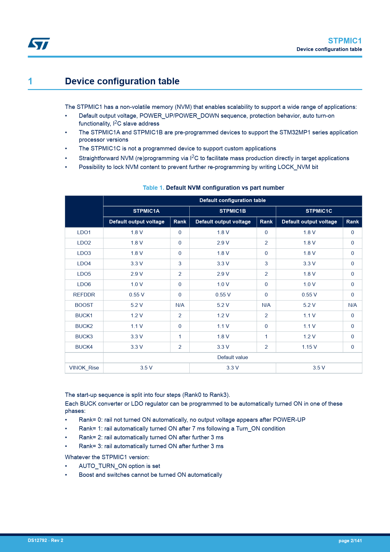

STPMIC1. Device configuration table. Table 1. Default NVM configuration vs part number. Default configuration table. STPMIC1A
STPMIC1 Device configuration table Table 1 Default NVM configuration vs part number Default configuration table STPMIC1A
STPMIC1 Device configuration table 1 Device configuration table
The STPMIC1 has a non-volatile memory (NVM) that enables scalability to support a wide range of applications: • Default output voltage, POWER_UP/POWER_DOWN sequence, protection behavior, auto turn-on functionality, I2C slave address • The STPMIC1A and STPMIC1B are pre-programmed devices to support the STM32MP1 series application processor versions • The STPMIC1C is not a programmed device to support custom applications • Straightforward NVM (re)programming via I2C to facilitate mass production directly in target applications • Possibility to lock NVM content to prevent further re-programming by writing LOCK_NVM bit
Table 1. Default NVM configuration vs part number Default configuration table STPMIC1A STPMIC1B STPMIC1C Default output voltage Rank Default output voltage Rank Default output voltage Rank
LDO1 1.8 V 0 1.8 V 0 1.8 V 0 LDO2 1.8 V 0 2.9 V 2 1.8 V 0 LDO3 1.8 V 0 1.8 V 0 1.8 V 0 LDO4 3.3 V 3 3.3 V 3 3.3 V 0 LDO5 2.9 V 2 2.9 V 2 1.8 V 0 LDO6 1.0 V 0 1.0 V 0 1.0 V 0 REFDDR 0.55 V 0 0.55 V 0 0.55 V 0 BOOST 5.2 V N/A 5.2 V N/A 5.2 V N/A BUCK1 1.2 V 2 1.2 V 2 1.1 V 0 BUCK2 1.1 V 0 1.1 V 0 1.1 V 0 BUCK3 3.3 V 1 1.8 V 1 1.2 V 0 BUCK4 3.3 V 2 3.3 V 2 1.15 V 0 Default value VINOK_Rise 3.5 V 3.3 V 3.5 V The start-up sequence is split into four steps (Rank0 to Rank3). Each BUCK converter or LDO regulator can be programmed to be automatically turned ON in one of these phases: • Rank= 0: rail not turned ON automatically, no output voltage appears after POWER-UP • Rank= 1: rail automatically turned ON after 7 ms following a Turn_ON condition • Rank= 2: rail automatically turned ON after further 3 ms • Rank= 3: rail automatically turned ON after further 3 ms Whatever the STPMIC1 version: • AUTO_TURN_ON option is set • Boost and switches cannot be turned ON automatically
