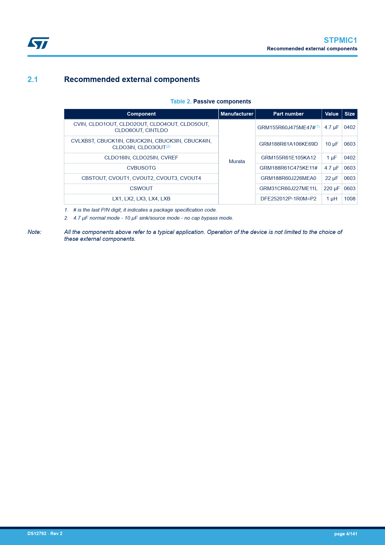

STPMIC1 Recommended external components 2.1 Recommended external components Table 2. Passive components Component Manufacturer Part number Value Size
CVIN, CLDO1OUT, CLDO2OUT, CLDO4OUT, CLDO5OUT, CLDO6OUT, CINTLDO GRM155R60J475ME47#(1) 4.7 µF 0402 CVLXBST, CBUCK1IN, CBUCK2IN, CBUCK3IN, CBUCK4IN, GRM188R61A106KE69D 10 µF 0603 CLDO3IN, CLDO3OUT(2) CLDO16IN, CLDO25IN, CVREF GRM155R61E105KA12 1 µF 0402 Murata CVBUSOTG GRM188R61C475KE11# 4.7 µF 0603 CBSTOUT, CVOUT1, CVOUT2, CVOUT3, CVOUT4 GRM188R60J226MEA0 22 µF 0603 CSWOUT GRM31CR60J227ME11L 220 µF 0603 LX1, LX2, LX3, LX4, LXB DFE252012P-1R0M=P2 1 µH 1008 1. # is the last P/N digit; it indicates a package specification code. 2. 4.7 µF normal mode - 10 µF sink/source mode - no cap bypass mode. Note: All the components above refer to a typical application. Operation of the device is not limited to the choice of these external components.
