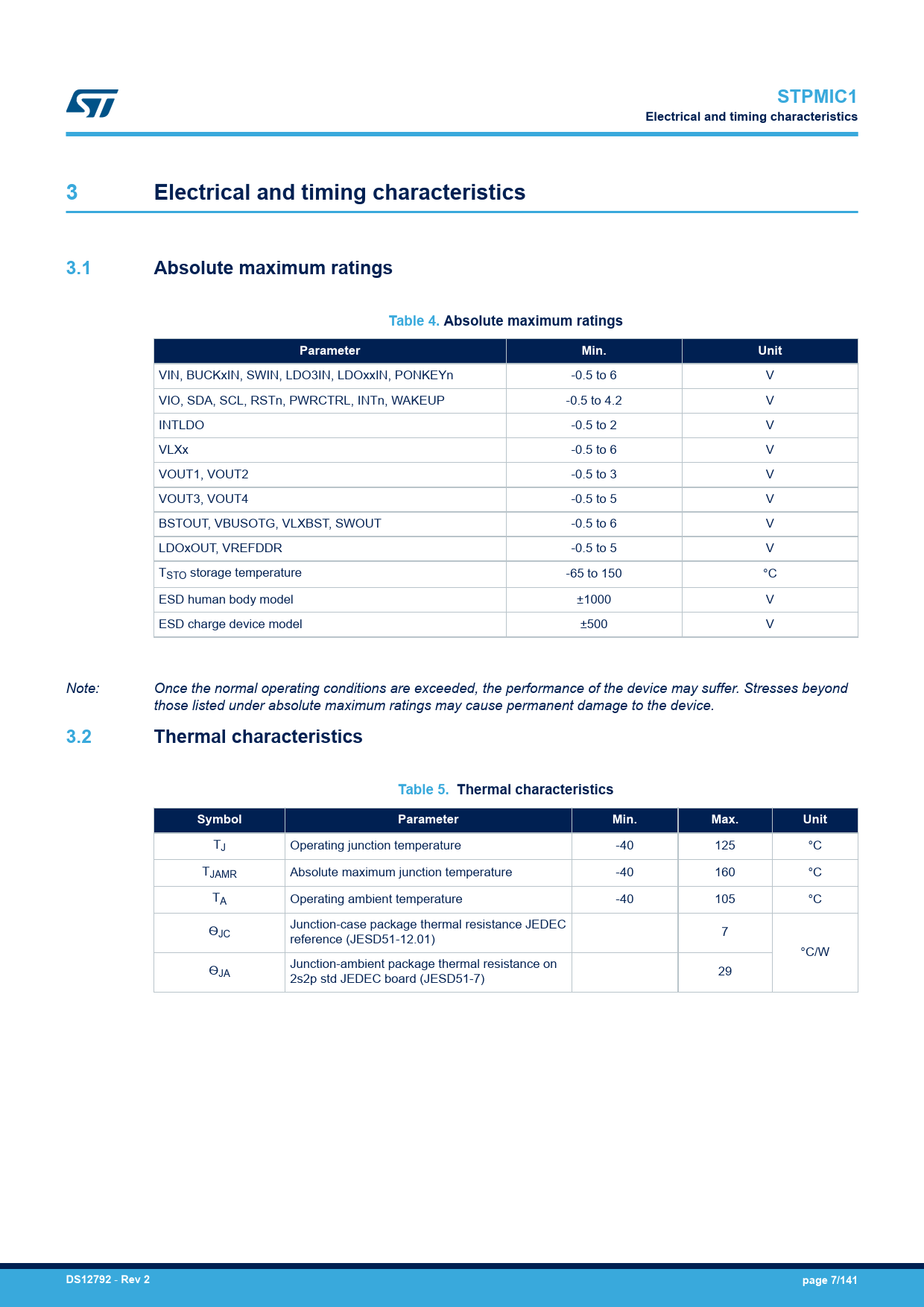

STPMIC1. Electrical and timing characteristics. 3.1. Absolute maximum ratings. Table 4. Absolute maximum ratings. Parameter. Min
STPMIC1 Electrical and timing characteristics 3 Electrical and timing characteristics 3.1 Absolute maximum ratings Table 4. Absolute maximum ratings Parameter Min. Unit
VIN, BUCKxIN, SWIN, LDO3IN, LDOxxIN, PONKEYn -0.5 to 6 V VIO, SDA, SCL, RSTn, PWRCTRL, INTn, WAKEUP -0.5 to 4.2 V INTLDO -0.5 to 2 V VLXx -0.5 to 6 V VOUT1, VOUT2 -0.5 to 3 V VOUT3, VOUT4 -0.5 to 5 V BSTOUT, VBUSOTG, VLXBST, SWOUT -0.5 to 6 V LDOxOUT, VREFDDR -0.5 to 5 V TSTO storage temperature -65 to 150 °C ESD human body model ±1000 V ESD charge device model ±500 V Note: Once the normal operating conditions are exceeded, the performance of the device may suffer. Stresses beyond those listed under absolute maximum ratings may cause permanent damage to the device.
3.2 Thermal characteristics Table 5. Thermal characteristics Symbol Parameter Min. Max. Unit
TJ Operating junction temperature -40 125 °C TJAMR Absolute maximum junction temperature -40 160 °C TA Operating ambient temperature -40 105 °C Ѳ Junction-case package thermal resistance JEDEC JC 7 reference (JESD51-12.01) °C/W Ѳ Junction-ambient package thermal resistance on JA 29 2s2p std JEDEC board (JESD51-7)
