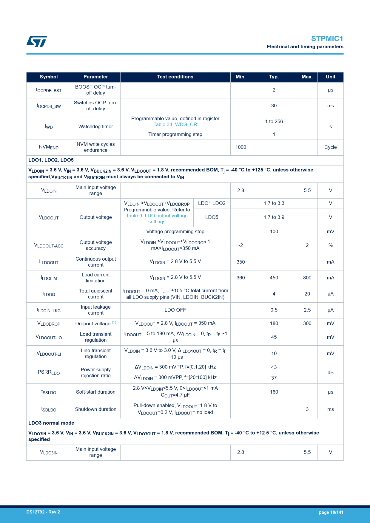

STPMIC1. Electrical and timing parameters. Symbol. Parameter. Test conditions. Min. Typ. Max. Unit. LDO1, LDO2, LDO5
STPMIC1 Electrical and timing parameters Symbol Parameter Test conditions Min Typ Max Unit LDO1, LDO2, LDO5
link to page 86 link to page 31 link to page 31 link to page 21
STPMIC1 Electrical and timing parameters Symbol Parameter Test conditions Min. Typ. Max. Unit
t BOOST OCP turn- OCPDB_BST 2 µs off delay t Switches OCP turn- OCPDB_SW 30 ms off delay Programmable value, defined in register 1 to 256 t Table 34. WDG_CR WD Watchdog timer s Timer programming step 1 NVM NVM write cycles END 1000 Cycle endurance
LDO1, LDO2, LDO5 VLDOIN = 3.6 V, VIN = 3.6 V, VBUCK2IN = 3.6 V, VLDOOUT = 1.8 V, recommended BOM, Tj = -40 °C to +125 °C, unless otherwise specified,VBUCK1IN and VBUCK2IN must always be connected to VIN
V Main input voltage LDOIN 2.8 5.5 V range VLDOIN >VLDOOUT+VLDODROP LDO1 LDO2 1.7 to 3.3 V Programmable value. Refer to V Table 9. LDO output voltage LDOOUT Output voltage LDO5 1.7 to 3.9 V settings Voltage programming step 100 mV V V Output voltage LDOIN >VLDOOUT+VLDODROP 1 LDOOUT-ACC -2 2 % accuracy mA<ILDOOUT<350 mA I Continuous output LDOOUT V current LDOIN = 2.8 V to 5.5 V 350 mA I Load current LDOLIM V limitation LDOIN = 2.8 V to 5.5 V 360 450 800 mA I I Total quiescent LDOOUT = 0 mA, TJ = +105 °C total current from LDOQ 4 20 µA current all LDO supply pins (VIN, LDOIN, BUCK2IN) I Input leakage LDOIN_LKG LDO OFF 0.5 2.5 µA current VLDODROP Dropout voltage (1) VLDOOUT = 2.8 V, ILDOOUT = 350 mA 180 300 mV I V Load transient LDOOUT = 5 to 180 mA, ΔVLDOIN = 0, tR = tF ~1 LDOOUT-LO 45 mV regulation µs V V Line transient LDOIN = 3.6 V to 3.0 V, ΔILDO1OUT = 0, tR = tF LDOOUT-LI 10 mV regulation ~10 μs ΔVLDOIN = 300 mVPP, f=[0.1:20] kHz 43 PSRR Power supply LDO dB rejection ratio ΔVLDOIN = 300 mVPP, f=[20:100] kHz 37 2.8 V<V t LDOIN<5.5 V, 0<ILDOOUT<1 mA SSLDO Soft-start duration 160 µs COUT=4.7 µF Pull-down enabled, V t LDOOUT=1.8 V to SDLDO Shutdown duration 3 ms VLDOOUT=0.2 V, ILDOOUT= no load
LDO3 normal mode VLDO3IN = 3.6 V, VIN = 3.6 V, VBUCK2IN = 3.6 V, VLDO3OUT = 1.8 V, recommended BOM, Tj = -40 °C to +12 5 °C, unless otherwise specified
V Main input voltage LDO3IN 2.8 5.5 V range
