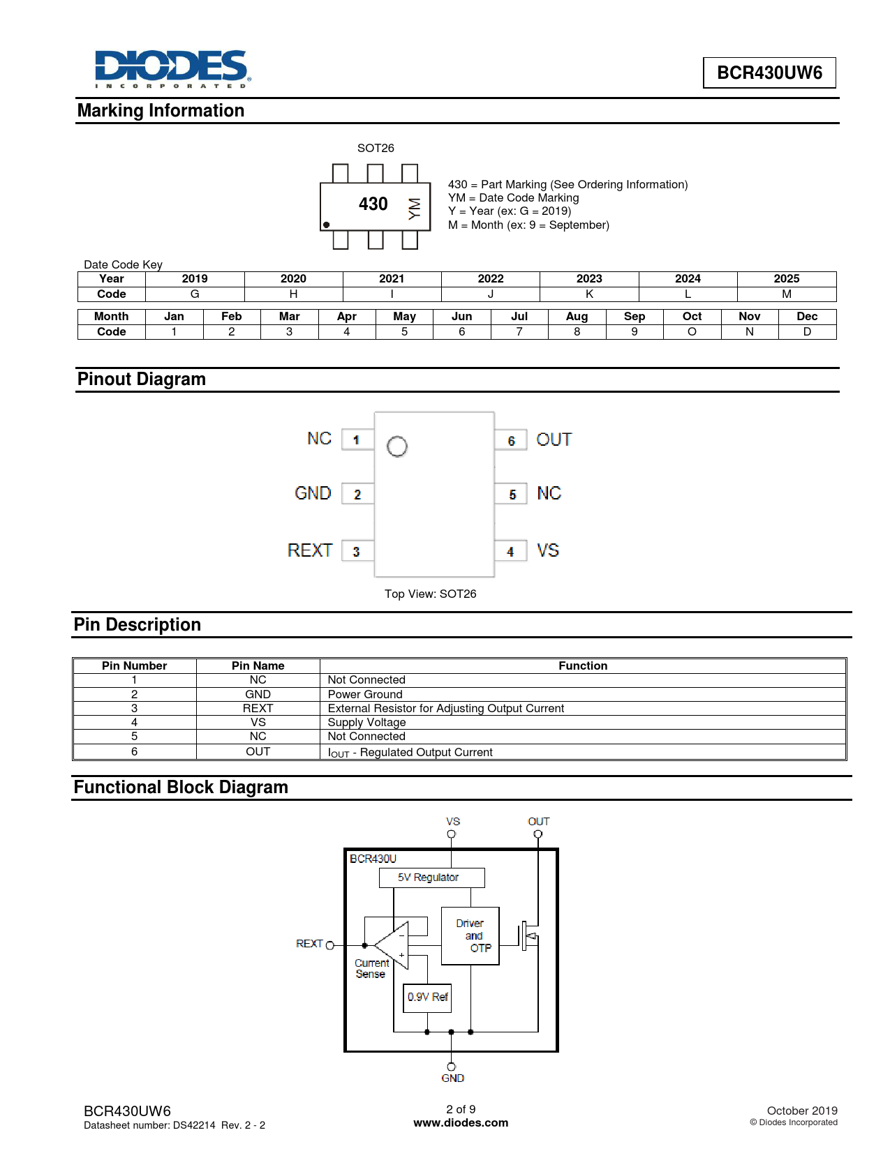

BCR430UW6 Marking Information
SOT26 430 = Part Marking (See Ordering Information) YM = Date Code Marking
430
Y = Year (ex: G = 2019) M = Month (ex: 9 = September) Date Code Key
Year 2019 2020 2021 2022 2023 2024 2025 Code
G H I J K L M
Month Jan Feb Mar Apr May Jun Jul Aug Sep Oct Nov Dec Code
1 2 3 4 5 6 7 8 9 O N D
Pinout Diagram
Top View: SOT26
Pin Description Pin Number Pin Name Function
1 NC Not Connected 2 GND Power Ground 3 REXT External Resistor for Adjusting Output Current 4 VS Supply Voltage 5 NC Not Connected 6 OUT IOUT - Regulated Output Current
Functional Block Diagram
