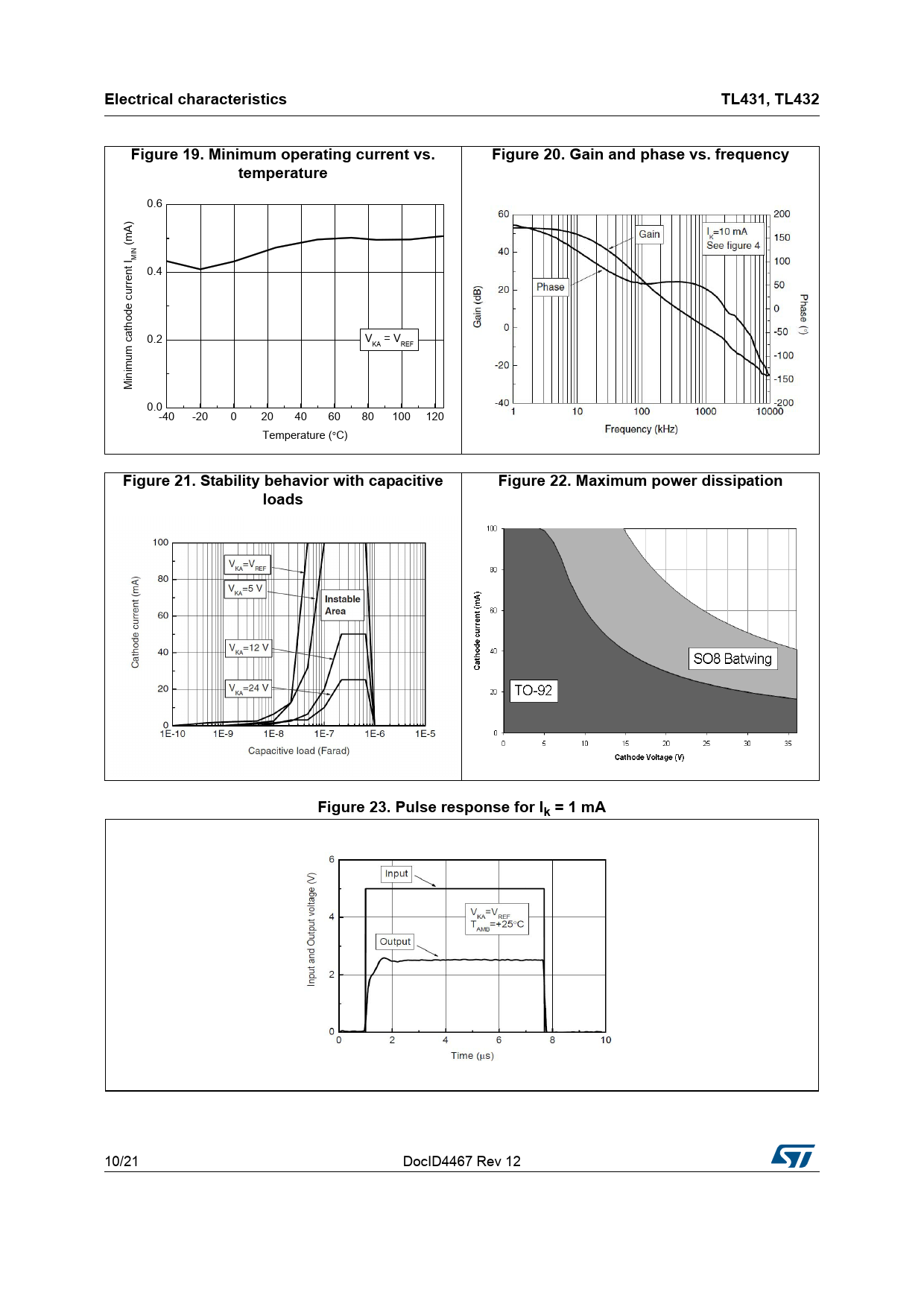

Pages / Page21 / 10 — Electrical characteristics. TL431, TL432. Figure 19. Minimum operating …
File Format / SizePDF / 862 Kb
Electrical characteristics. TL431, TL432. Figure 19. Minimum operating current vs. Figure 20. Gain and phase vs. frequency
Electrical characteristics TL431, TL432 Figure 19 Minimum operating current vs Figure 20 Gain and phase vs frequency
Electrical characteristics TL431, TL432 Figure 19. Minimum operating current vs. Figure 20. Gain and phase vs. frequency temperature
0.6 A) (m t I MIN 0.4 en rr cu ode ath c 0.2 V = V KA REF um im in M 0.0-40 -20 0 20 40 60 80 100 120 Temperature (C)
Figure 21. Stability behavior with capacitive Figure 22. Maximum power dissipation loads Figure 23. Pulse response for Ik = 1 mA
