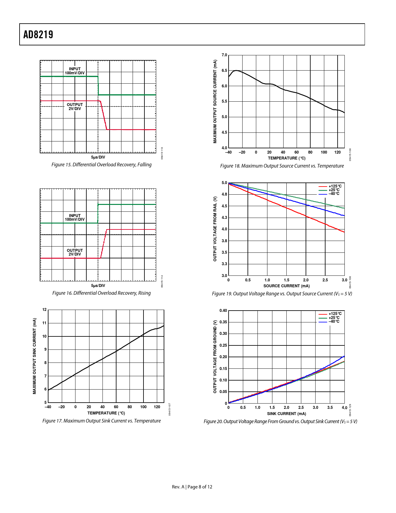

AD8219. 7.0. A) m. INPUT. 6.5. 100mV/DIV. NT RE. 6.0. CUR. RCE U. 5.5. OUTPUT. 2V/DIV. UT P. 5.0. UT O. 4.5. IM AX M. 4.0. –40. –20. 100. 120. 5µs/DIV

09 Figure 15. Differential Overload Recovery, Falling Figure 18. Maximum Output Source Current vs. Temperature

09 Figure 16. Differential Overload Recovery, Rising Figure 19. Output Voltage Range vs. Output Source Current (VS = 5 V)

09 Figure 17. Maximum Output Sink Current vs. Temperature Figure 20. Output Voltage Range From Ground vs. Output Sink Current (VS = 5 V) Rev. A | Page 8 of 12 Document Outline FEATURES APPLICATIONS GENERAL DESCRIPTION FUNCTIONAL BLOCK DIAGRAM TABLE OF CONTENTS REVISION HISTORY SPECIFICATIONS ABSOLUTE MAXIMUM RATINGS ESD CAUTION PIN CONFIGURATION AND FUNCTION DESCRIPTIONS TYPICAL PERFORMANCE CHARACTERISTICS THEORY OF OPERATION AMPLIFIER CORE SUPPLY CONNECTIONS OUTPUT CLAMPING OUTPUT LINEARITY APPLICATIONS INFORMATION HIGH-SIDE CURRENT SENSING MOTOR CONTROL CURRENT SENSING OUTLINE DIMENSIONS ORDERING GUIDE
