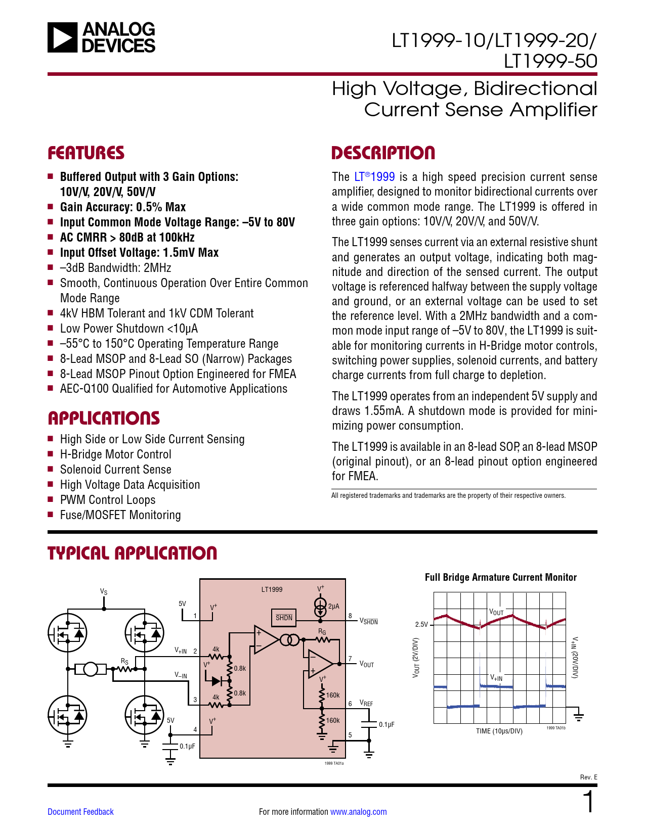

The LT®1999 is a high speed precision current sense
10V/V, 20V/V, 50V/V
amplifier, designed to monitor bidirectional currents over n
Gain Accuracy: 0.5% Max
a wide common mode range. The LT1999 is offered in n
Input Common Mode Voltage Range: –5V to 80V
three gain options: 10V/V, 20V/V, and 50V/V. n
AC CMRR > 80dB at 100kHz
The LT1999 senses current via an external resistive shunt n
Input Offset Voltage: 1.5mV Max
and generates an output voltage, indicating both mag- n –3dB Bandwidth: 2MHz nitude and direction of the sensed current. The output n Smooth, Continuous Operation Over Entire Common voltage is referenced halfway between the supply voltage Mode Range and ground, or an external voltage can be used to set n 4kV HBM Tolerant and 1kV CDM Tolerant the reference level. With a 2MHz bandwidth and a com- n Low Power Shutdown <10µA mon mode input range of –5V to 80V, the LT1999 is suit- n –55°C to 150°C Operating Temperature Range able for monitoring currents in H-Bridge motor controls, n 8-Lead MSOP and 8-Lead SO (Narrow) Packages switching power supplies, solenoid currents, and battery n 8-Lead MSOP Pinout Option Engineered for FMEA charge currents from full charge to depletion. n AEC-Q100 Qualified for Automotive Applications The LT1999 operates from an independent 5V supply and draws 1.55mA. A shutdown mode is provided for mini-
APPLICATIONS
mizing power consumption. n High Side or Low Side Current Sensing The LT1999 is available in an 8-lead SOP, an 8-lead MSOP n H-Bridge Motor Control (original pinout), or an 8-lead pinout option engineered n Solenoid Current Sense for FMEA. n High Voltage Data Acquisition All registered trademarks and trademarks are the property of their respective owners. n PWM Control Loops n Fuse/MOSFET Monitoring
TYPICAL APPLICATION Full Bridge Armature Current Monitor
