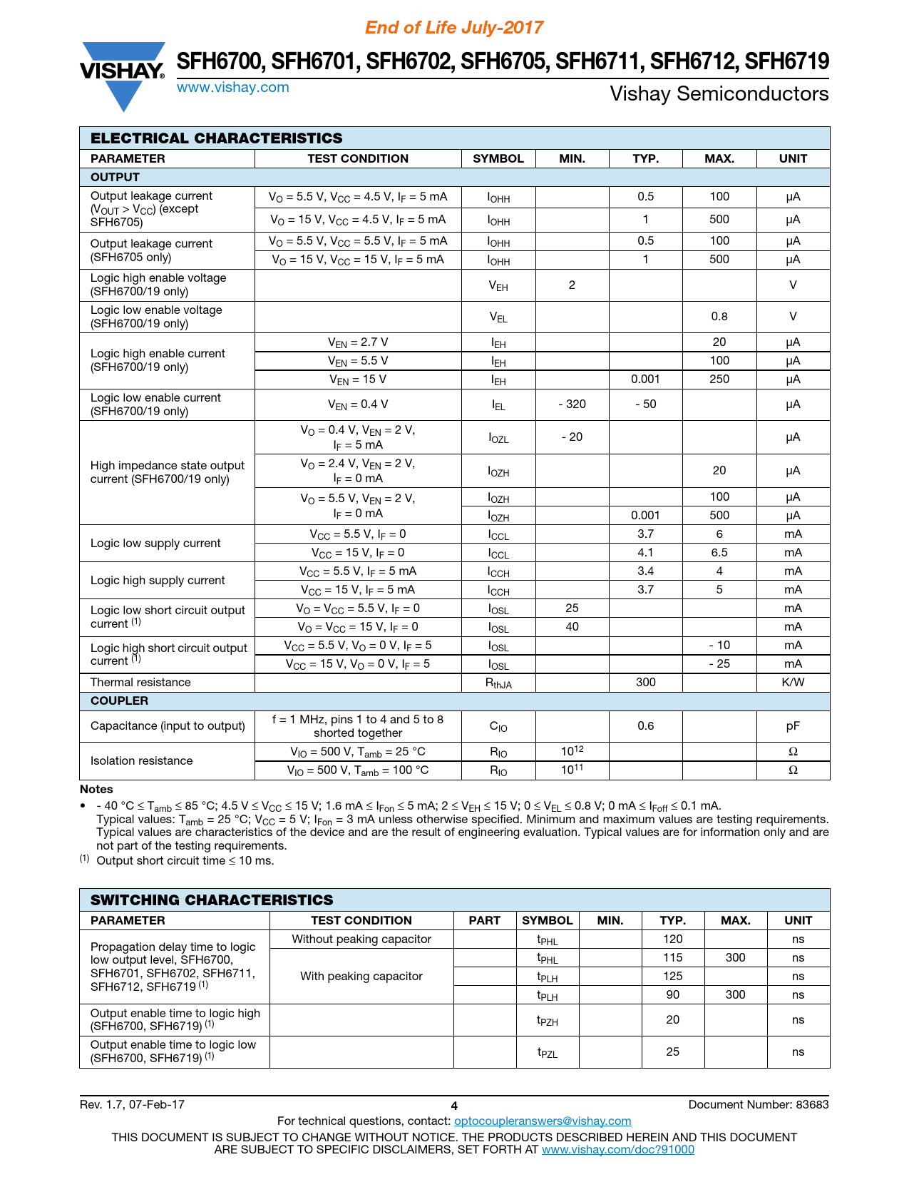

End of Life July-2017. SFH6700, SFH6701, SFH6702, SFH6705, SFH6711, SFH6712, SFH6719. ELECTRICAL CHARACTERISTICS PARAMETER
End of Life July-2017 SFH6700, SFH6701, SFH6702, SFH6705, SFH6711, SFH6712, SFH6719 ELECTRICAL CHARACTERISTICS PARAMETER
ELECTRICAL CHARACTERISTICS PARAMETER TEST CONDITION SYMBOL MIN. TYP. MAX. UNIT OUTPUT
Output leakage current VO = 5.5 V, VCC = 4.5 V, IF = 5 mA IOHH 0.5 100 μA (VOUT > VCC) (except SFH6705) VO = 15 V, VCC = 4.5 V, IF = 5 mA IOHH 1 500 μA Output leakage current VO = 5.5 V, VCC = 5.5 V, IF = 5 mA IOHH 0.5 100 μA (SFH6705 only) VO = 15 V, VCC = 15 V, IF = 5 mA IOHH 1 500 μA Logic high enable voltage V (SFH6700/19 only) EH 2 V Logic low enable voltage V (SFH6700/19 only) EL 0.8 V VEN = 2.7 V IEH 20 μA Logic high enable current V (SFH6700/19 only) EN = 5.5 V IEH 100 μA VEN = 15 V IEH 0.001 250 μA Logic low enable current V (SFH6700/19 only) EN = 0.4 V IEL - 320 - 50 μA VO = 0.4 V, VEN = 2 V, I I OZL - 20 μA F = 5 mA High impedance state output VO = 2.4 V, VEN = 2 V, IOZH 20 μA current (SFH6700/19 only) IF = 0 mA V I O = 5.5 V, VEN = 2 V, OZH 100 μA IF = 0 mA IOZH 0.001 500 μA VCC = 5.5 V, IF = 0 ICCL 3.7 6 mA Logic low supply current VCC = 15 V, IF = 0 ICCL 4.1 6.5 mA VCC = 5.5 V, IF = 5 mA ICCH 3.4 4 mA Logic high supply current VCC = 15 V, IF = 5 mA ICCH 3.7 5 mA Logic low short circuit output VO = VCC = 5.5 V, IF = 0 IOSL 25 mA current (1) VO = VCC = 15 V, IF = 0 IOSL 40 mA Logic high short circuit output VCC = 5.5 V, VO = 0 V, IF = 5 IOSL - 10 mA current (1) VCC = 15 V, VO = 0 V, IF = 5 IOSL - 25 mA Thermal resistance RthJA 300 K/W
COUPLER
f = 1 MHz, pins 1 to 4 and 5 to 8 Capacitance (input to output) C shorted together IO 0.6 pF VIO = 500 V, Tamb = 25 °C RIO 1012 Ω Isolation resistance VIO = 500 V, Tamb = 100 °C RIO 1011 Ω
Notes
• - 40 °C ≤ Tamb ≤ 85 °C; 4.5 V ≤ VCC ≤ 15 V; 1.6 mA ≤ IFon ≤ 5 mA; 2 ≤ VEH ≤ 15 V; 0 ≤ VEL ≤ 0.8 V; 0 mA ≤ IFoff ≤ 0.1 mA. Typical values: Tamb = 25 °C; VCC = 5 V; IFon = 3 mA unless otherwise specified. Minimum and maximum values are testing requirements. Typical values are characteristics of the device and are the result of engineering evaluation. Typical values are for information only and are not part of the testing requirements. (1) Output short circuit time ≤ 10 ms.
SWITCHING CHARACTERISTICS PARAMETER TEST CONDITION PART SYMBOL MIN. TYP. MAX. UNIT
Without peaking capacitor t Propagation delay time to logic PHL 120 ns low output level, SFH6700, tPHL 115 300 ns SFH6701, SFH6702, SFH6711, With peaking capacitor tPLH 125 ns SFH6712, SFH6719 (1) tPLH 90 300 ns Output enable time to logic high (SFH6700, SFH6719) (1) tPZH 20 ns Output enable time to logic low (SFH6700, SFH6719) (1) tPZL 25 ns Rev. 1.7, 07-Feb-17
