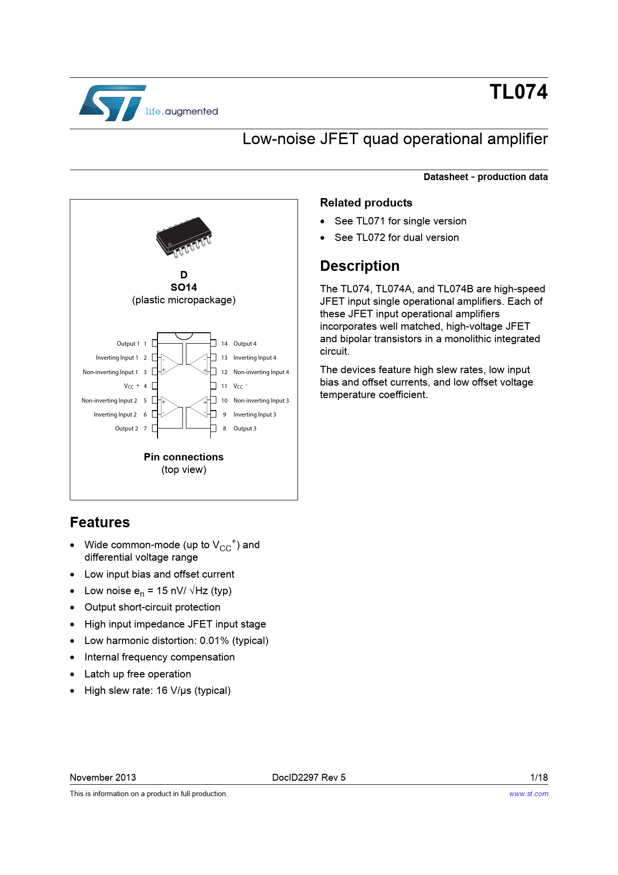

TL074
Low-noise JFET quad operational amplifier
Datasheet
production data Related products
• See TL071 for single version • See TL072 for dual version
Description D SO14
The TL074, TL074A, and TL074B are high-speed (plastic micropackage) JFET input single operational amplifiers. Each of these JFET input operational amplifiers incorporates well matched, high-voltage JFET and bipolar transistors in a monolithic integrated Output 1 1 14 Output 4 circuit. Inverting Input 1 2 13 Inverting Input 4 - - Non-inverting Input 1 3 + + 12 Non-inverting Input 4 The devices feature high slew rates, low input + bias and offset currents, and low offset voltage CC V - 4 11 VCC temperature coefficient. Non-inverting Input 2 5 10 Non-inverting Input 3 + + Inverting Input 2 6 - - 9 Inverting Input 3 Output 2 7 8 Output 3
Pin connections
(top view)
Features
• Wide common-mode (up to V + CC ) and differential voltage range • Low input bias and offset current • Low noise en = 15 nV/ √ Hz (typ) • Output short-circuit protection • High input impedance JFET input stage • Low harmonic distortion: 0.01% (typical) • Internal frequency compensation • Latch up free operation • High slew rate: 16 V/µs (typical) November 2013 DocID2297 Rev 5 1/18 This is information on a product in full production. www.st.com Document Outline 1 Schematic diagram Figure 1. Circuit schematic 2 Absolute maximum ratings and operating conditions Table 1. Absolute maximum ratings Table 2. Operating conditions 3 Electrical characteristics Table 3. VCC = ±15 V, Tamb = +25 °C (unless otherwise specified) Figure 2. Maximum peak-to-peak output voltage versus frequency Figure 3. Maximum peak-to-peak output voltage versus frequency Figure 4. Maximum peak-to-peak output voltage versus frequency Figure 5. Maximum peak-to-peak output voltage versus free air temperature Figure 6. Maximum peak-to-peak output voltage versus load resistance Figure 7. Maximum peak-to-peak output voltage versus supply voltage Figure 8. Input bias current versus free air temperature Figure 9. Large signal differential voltage amplification versus free air temperature Figure 10. Large signal differential voltage amplification and phase shift versus frequency Figure 11. Total power dissipation versus free air temperature Figure 12. Supply current per amplifier versus free air temperature Figure 13. Common mode rejection ratio versus free air temperature Figure 14. Voltage follower large signal pulse response Figure 15. Output voltage versus elapsed time Figure 16. Equivalent input noise voltage versus frequency Figure 17. Total harmonic distortion versus frequency 4 Parameter measurement information Figure 18. Voltage follower Figure 19. Gain-of-10 inverting amplifier 5 Typical applications Figure 20. Audio distribution amplifier Figure 21. Positive feeback bandpass filter Figure 22. Output A Figure 23. Output B 6 Package information 6.1 SO14 package information Figure 24. SO14 package mechanical drawing Table 4. SO14 package mechanical data 7 Ordering information Table 5. Order codes 8 Revision history Table 6. Document revision history
