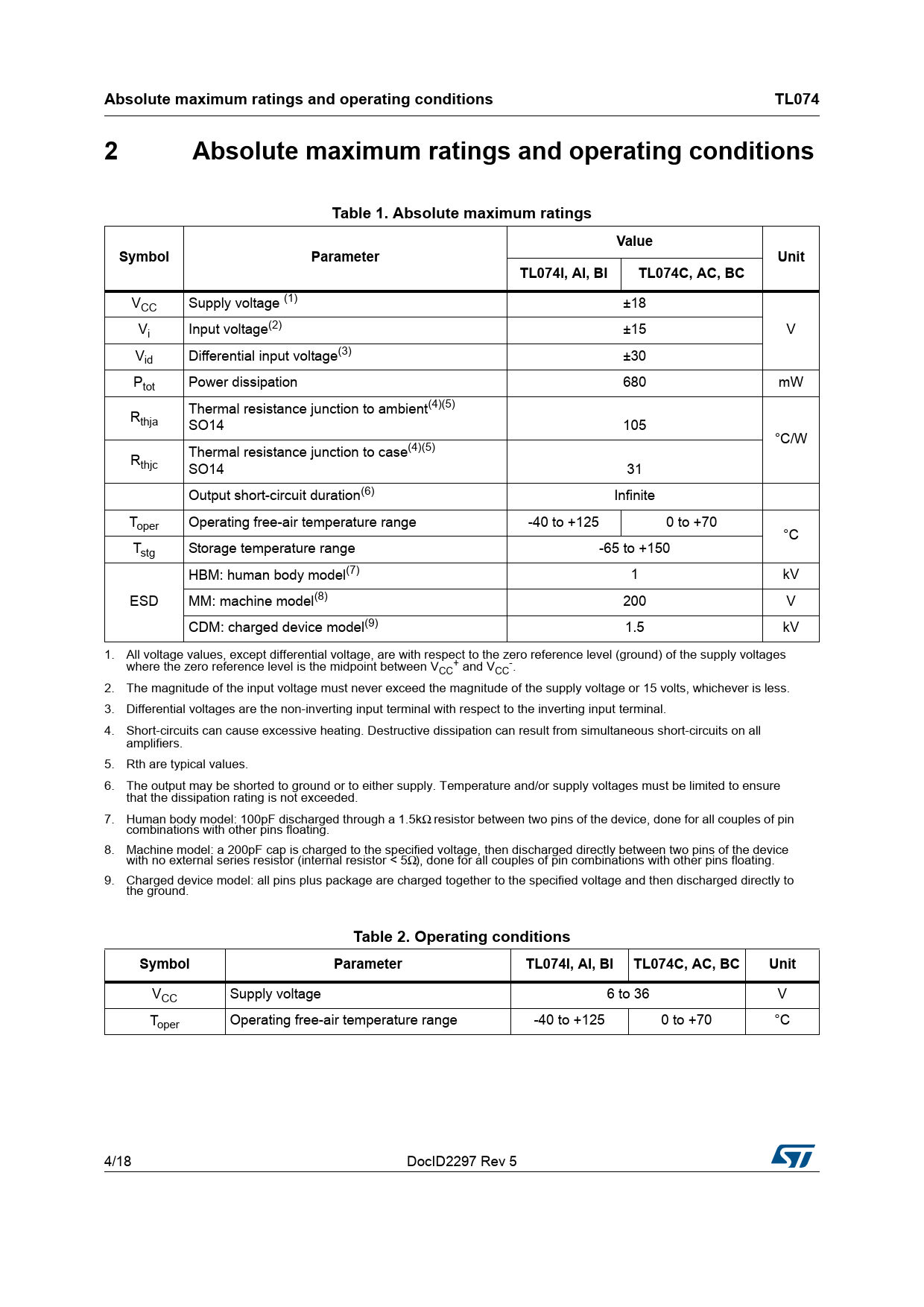

Absolute maximum ratings and operating conditions TL074 2 Absolute maximum ratings and operating conditions Table 1. Absolute maximum ratings Value Symbol Parameter Unit TL074I, AI, BI TL074C, AC, BC
VCC Supply voltage (1) ±18 V V i Input voltage(2) ±15 Vid Differential input voltage(3) ±30 Ptot Power dissipation 680 mW Thermal resistance junction to ambient(4)(5) Rthja SO14 105 °C/W Thermal resistance junction to case(4)(5) Rthjc SO14 31 Output short-circuit duration(6) Infinite Toper Operating free-air temperature range -40 to +125 0 to +70 °C Tstg Storage temperature range -65 to +150 HBM: human body model(7) 1 kV ESD MM: machine model(8) 200 V CDM: charged device model(9) 1.5 kV 1. All voltage values, except differential voltage, are with respect to the zero reference level (ground) of the supply voltages where the zero reference level is the midpoint between V + - CC and VCC . 2. The magnitude of the input voltage must never exceed the magnitude of the supply voltage or 15 volts, whichever is less. 3. Differential voltages are the non-inverting input terminal with respect to the inverting input terminal. 4. Short-circuits can cause excessive heating. Destructive dissipation can result from simultaneous short-circuits on all amplifiers. 5. Rth are typical values. 6. The output may be shorted to ground or to either supply. Temperature and/or supply voltages must be limited to ensure that the dissipation rating is not exceeded. 7. Human body model: 100pF discharged through a 1.5kΩ resistor between two pins of the device, done for all couples of pin combinations with other pins floating. 8. Machine model: a 200pF cap is charged to the specified voltage, then discharged directly between two pins of the device with no external series resistor (internal resistor < 5Ω), done for all couples of pin combinations with other pins floating. 9. Charged device model: all pins plus package are charged together to the specified voltage and then discharged directly to the ground.
Table 2. Operating conditions Symbol Parameter TL074I, AI, BI TL074C, AC, BC Unit
VCC Supply voltage 6 to 36 V Toper Operating free-air temperature range -40 to +125 0 to +70 °C 4/18 DocID2297 Rev 5 Document Outline 1 Schematic diagram Figure 1. Circuit schematic 2 Absolute maximum ratings and operating conditions Table 1. Absolute maximum ratings Table 2. Operating conditions 3 Electrical characteristics Table 3. VCC = ±15 V, Tamb = +25 °C (unless otherwise specified) Figure 2. Maximum peak-to-peak output voltage versus frequency Figure 3. Maximum peak-to-peak output voltage versus frequency Figure 4. Maximum peak-to-peak output voltage versus frequency Figure 5. Maximum peak-to-peak output voltage versus free air temperature Figure 6. Maximum peak-to-peak output voltage versus load resistance Figure 7. Maximum peak-to-peak output voltage versus supply voltage Figure 8. Input bias current versus free air temperature Figure 9. Large signal differential voltage amplification versus free air temperature Figure 10. Large signal differential voltage amplification and phase shift versus frequency Figure 11. Total power dissipation versus free air temperature Figure 12. Supply current per amplifier versus free air temperature Figure 13. Common mode rejection ratio versus free air temperature Figure 14. Voltage follower large signal pulse response Figure 15. Output voltage versus elapsed time Figure 16. Equivalent input noise voltage versus frequency Figure 17. Total harmonic distortion versus frequency 4 Parameter measurement information Figure 18. Voltage follower Figure 19. Gain-of-10 inverting amplifier 5 Typical applications Figure 20. Audio distribution amplifier Figure 21. Positive feeback bandpass filter Figure 22. Output A Figure 23. Output B 6 Package information 6.1 SO14 package information Figure 24. SO14 package mechanical drawing Table 4. SO14 package mechanical data 7 Ordering information Table 5. Order codes 8 Revision history Table 6. Document revision history
