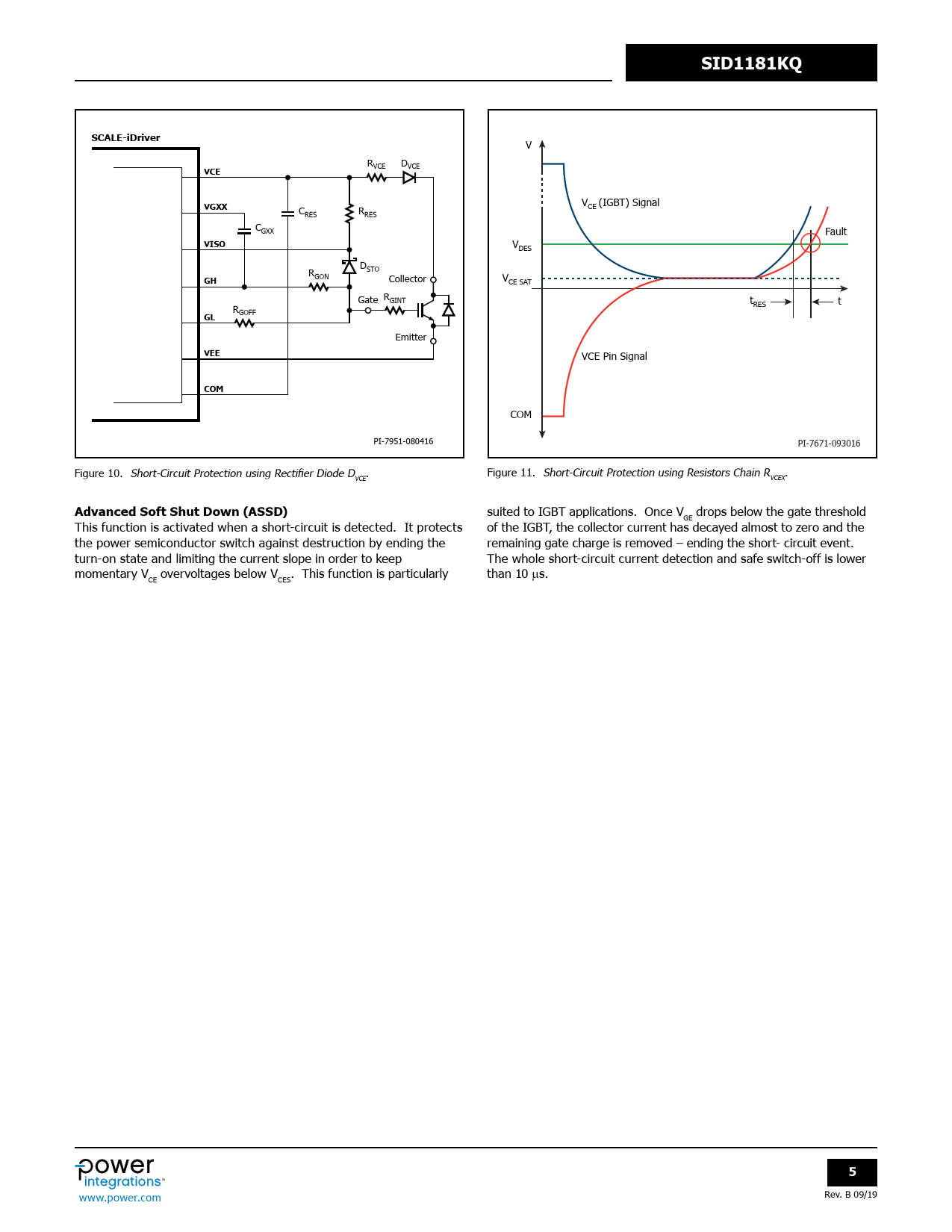

SID1181KQ. SCALE-iDriver. VCE. VGXX. VISO. VEE. COM. Advanced Soft Shut Down (ASSD)
SID1181KQ SCALE-iDriver VCE VGXX VISO VEE COM Advanced Soft Shut Down (ASSD)
V RVCE DVCE
VCE
V
VGXX
CE (IGBT) Signal C R RES RES CGXX Fault
VISO
VDES DSTO R
GH
GON Collector VCE SAT Gate RGINT tRES t RGOFF
GL
Emitter
VEE
VCE Pin Signal
COM
COM PI-7951-080416 PI-7671-093016 Figure 10. Short-Circuit Protection using Rectifier Diode D . Figure 11. Short-Circuit Protection using Resistors Chain R . VCE VCEX
suited to IGBT applications. Once V drops below the gate threshold GE This function is activated when a short-circuit is detected. It protects of the IGBT, the col ector current has decayed almost to zero and the the power semiconductor switch against destruction by ending the remaining gate charge is removed ‒ ending the short- circuit event. turn-on state and limiting the current slope in order to keep The whole short-circuit current detection and safe switch-off is lower momentary V overvoltages below V . This function is particularly than 10 µs. CE CES
