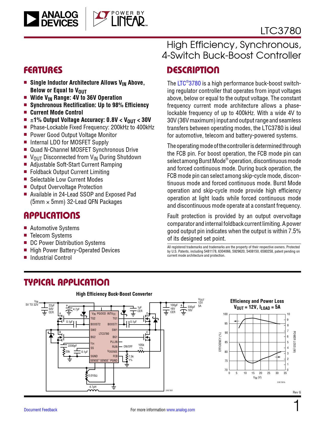

FEATURES. DESCRIPTION. Single Inductor Architecture Allows VIN Above,. Below or Equal to VOUT
Datasheet LTC3780 Analog Devices, Revision: G
LTC3780 High Efficiency, Synchronous, 4-Switch Buck-Boost Controller
FEATURES DESCRIPTION
n
The LTC®3780 is a high performance buck-boost switch-
ing regulator controller that operates from input voltages n
Wide VIN Range: 4V to 36V Operation
above, below or equal to the output voltage. The constant n
Synchronous Rectification: Up to 98% Efficiency
frequency current mode architecture allows a phase- n
Current Mode Control
lockable frequency of up to 400kHz. With a wide 4V to n ±
1% Output Voltage Accuracy: 0.8V < VOUT < 30V
30V (36V maximum) input and output range and seamless n Phase-Lockable Fixed Frequency: 200kHz to 400kHz transfers between operating modes, the LTC3780 is ideal n Power Good Output Voltage Monitor for automotive, telecom and battery-powered systems. n Internal LDO for MOSFET Supply The operating mode of the controller is determined through n Quad N-Channel MOSFET Synchronous Drive the FCB pin. For boost operation, the FCB mode pin can n VOUT Disconnected from VIN During Shutdown select among Burst Mode® operation, discontinuous mode n Adjustable Soft-Start Current Ramping and forced continuous mode. During buck operation, the n Foldback Output Current Limiting FCB mode pin can select among skip-cycle mode, discon- n Selectable Low Current Modes tinuous mode and forced continuous mode. Burst Mode n Output Overvoltage Protection operation and skip-cycle mode provide high efficiency n Available in 24-Lead SSOP and Exposed Pad operation at light loads while forced continuous mode (5mm × 5mm) 32-Lead QFN Packages and discontinuous mode operate at a constant frequency.
APPLICATIONS
Fault protection is provided by an output overvoltage comparator and internal foldback current limiting. A power n Automotive Systems good output pin indicates when the output is within 7.5% n Telecom Systems of its designed set point. n DC Power Distribution Systems All registered trademarks and trademarks are the property of their respective owners. Protected n High Power Battery-Operated Devices by U.S. Patents, including 5481178, 6304066, 5929620, 5408150, 6580258, patent pending on current mode architecture and protection. n Industrial Control
TYPICAL APPLICATION High Efficiency Buck-Boost Converter
V V OUT IN 12V
Efficiency and Power Loss
5V TO 32V 22µF + 100µF + 330µF 5A
V
50V 4.7µF 1µF 16V
OUT = 12V, ILOAD = 5A
