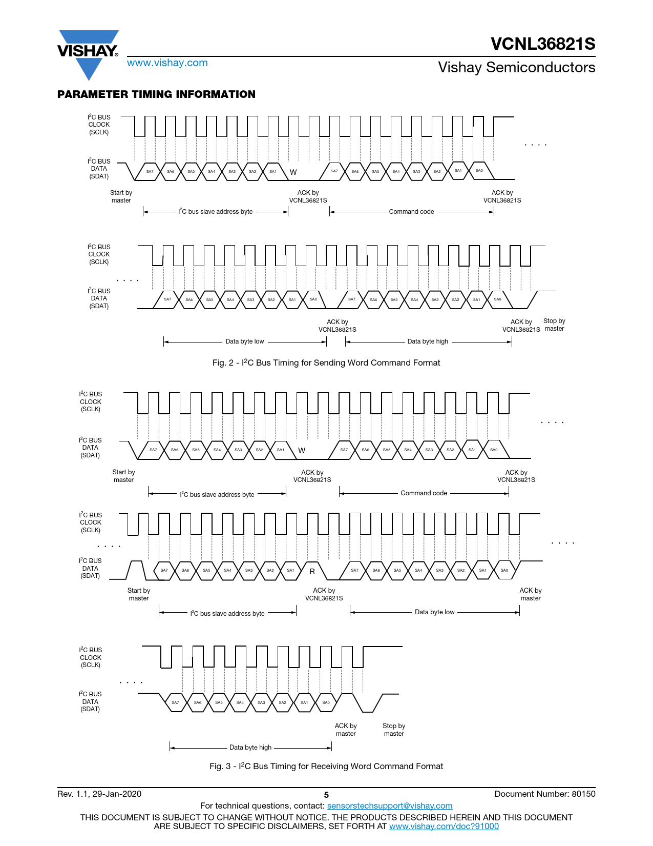

VCNL36821S. PARAMETER TIMING INFORMATION
VCNL36821S PARAMETER TIMING INFORMATION
VCNL36821S
I2C BUS CLOCK (SCLK) I2C BUS DATA SA7 SA6 SA5 SA4 SA3 SA2 SA1 W SA6 SA5 SA4 SA3 SA2 SA1 SA0 SA7 (SDAT) Start by ACK by ACK by master VCNL36821S VCNL36821S I2C bus slave address byte Command code I2C BUS CLOCK (SCLK) I2C BUS DATA SA7 SA6 SA5 SA4 SA3 SA2 SA1 SA0 SA7 SA6 SA5 SA4 SA3 SA2 SA1 SA0 (SDAT) ACK by ACK by Stop by VCNL36821S VCNL36821S master Data byte low Data byte high Fig. 2 - I2C Bus Timing for Sending Word Command Format I2C BUS CLOCK (SCLK) I2C BUS DATA SA7 SA6 SA5 SA4 SA3 SA2 SA1 W SA7 SA6 SA5 SA4 SA3 SA2 SA1 SA0 (SDAT) Start by ACK by ACK by master VCNL36821S VCNL36821S I2C bus slave address byte Command code I2C BUS CLOCK (SCLK) I2C BUS DATA SA7 SA6 SA5 SA4 SA3 SA2 SA1 R SA7 SA6 SA5 SA4 SA3 SA2 SA1 SA0 (SDAT) Start by ACK by ACK by master VCNL36821S master I2C bus slave address byte Data byte low I2C BUS CLOCK (SCLK) I2C BUS DATA SA7 SA6 SA5 SA4 SA3 SA2 SA1 SA0 (SDAT) ACK by Stop by master master Data byte high Fig. 3 - I2C Bus Timing for Receiving Word Command Format Rev. 1.1, 29-Jan-2020
