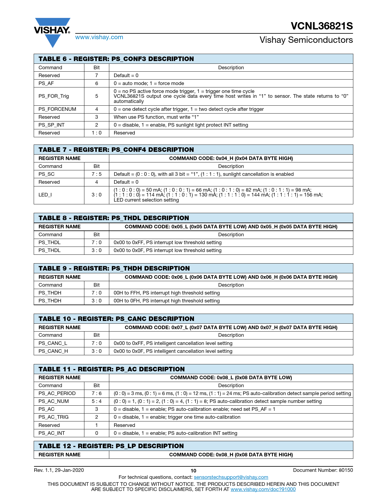

TABLE 6 - REGISTER: PS_CONF3 DESCRIPTION
Command Bit Description Reserved 7 Default = 0 PS_AF 6 0 = auto mode; 1 = force mode 0 = no PS active force mode trigger, 1 = trigger one time cycle PS_FOR_Trig 5 VCNL36821S output one cycle data every time host writes in “1” to sensor. The state returns to “0” automatically PS_FORCENUM 4 0 = one detect cycle after trigger, 1 = two detect cycle after trigger Reserved 3 When use PS function, must write “1” PS_SP_INT 2 0 = disable, 1 = enable, PS sunlight light protect INT setting Reserved 1 : 0 Reserved
TABLE 7 - REGISTER: PS_CONF4 DESCRIPTION REGISTER NAME COMMAND CODE: 0x04_H (0x04 DATA BYTE HIGH)
Command Bit Description PS_SC 7 : 5 Default = (0 : 0 : 0), with all 3 bit = “1”, (1 : 1 : 1), sunlight cancellation is enabled Reserved 4 Default = 0 (1 : 0 : 0 : 0) = 50 mA; (1 : 0 : 0 : 1) = 66 mA; (1 : 0 : 1 : 0) = 82 mA; (1 : 0 : 1 : 1) = 98 mA; LED_I 3 : 0 (1 : 1 : 0 : 0) = 114 mA; (1 : 1 : 0 : 1) = 130 mA; (1 : 1 : 1 : 0) = 144 mA; (1 : 1 : 1 : 1) = 156 mA; LED current selection setting
TABLE 8 - REGISTER: PS_THDL DESCRIPTION REGISTER NAME COMMAND CODE: 0x05_L (0x05 DATA BYTE LOW) AND 0x05_H (0x05 DATA BYTE HIGH)
Command Bit Description PS_THDL 7 : 0 0x00 to 0xFF, PS interrupt low threshold setting PS_THDL 3 : 0 0x00 to 0x0F, PS interrupt low threshold setting
TABLE 9 - REGISTER: PS_THDH DESCRIPTION REGISTER NAME COMMAND CODE: 0x06_L (0x06 DATA BYTE LOW) AND 0x06_H (0x06 DATA BYTE HIGH)
Command Bit Description PS_THDH 7 : 0 00H to FFH, PS interrupt high threshold setting PS_THDH 3 : 0 00H to 0FH, PS interrupt high threshold setting
TABLE 10 - REGISTER: PS_CANC DESCRIPTION REGISTER NAME COMMAND CODE: 0x07_L (0x07 DATA BYTE LOW) AND 0x07_H (0x07 DATA BYTE HIGH)
Command Bit Description PS_CANC_L 7 : 0 0x00 to 0xFF, PS intelligent cancellation level setting PS_CANC_H 3 : 0 0x00 to 0x0F, PS intelligent cancellation level setting
TABLE 11 - REGISTER: PS_AC DESCRIPTION REGISTER NAME COMMAND CODE: 0x08_L (0x08 DATA BYTE LOW)
Command Bit Description PS_AC_PERIOD 7 : 6 (0 : 0) = 3 ms, (0 : 1) = 6 ms, (1 : 0) = 12 ms, (1 : 1) = 24 ms; PS auto-calibration detect sample period setting PS_AC_NUM 5 : 4 (0 : 0) = 1, (0 : 1) = 2, (1 : 0) = 4, (1 : 1) = 8; PS auto-calibration detect sample number setting PS_AC 3 0 = disable, 1 = enable; PS auto-calibration enable; need set PS_AF = 1 PS_AC_TRIG 2 0 = disable, 1 = enable; trigger one time auto-calibration Reserved 1 Reserved PS_AC_INT 0 0 = disable, 1 = enable; PS auto-calibration INT setting
TABLE 12 - REGISTER: PS_LP DESCRIPTION REGISTER NAME COMMAND CODE: 0x08_H (0x08 DATA BYTE HIGH)
