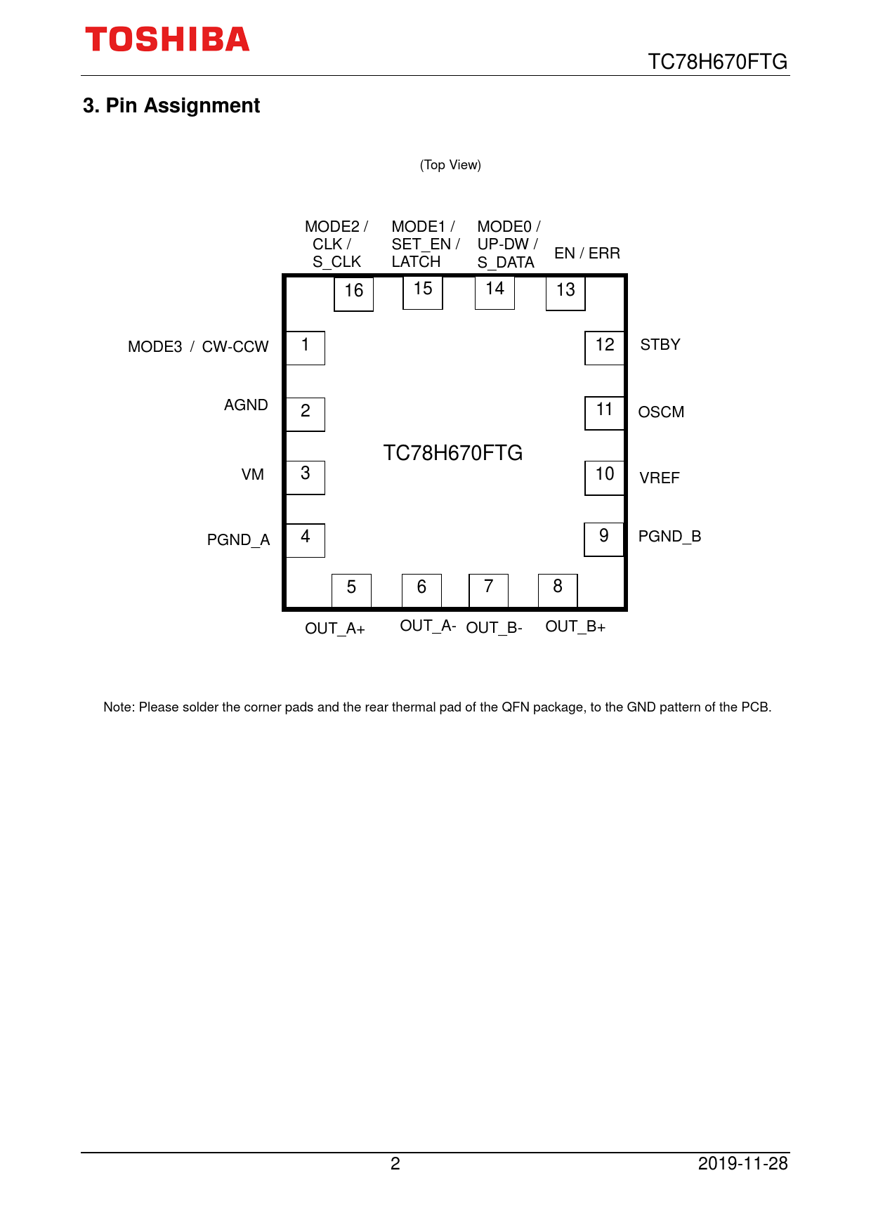

3. Pin Assignment
TC78H670FTG
3. Pin Assignment
(Top View) MODE2 / MODE1 / MODE0 / CLK / SET_EN / UP-DW / EN / ERR S_CLK LATCH S_DATA 16 15 14 13 MODE3 / CW-CCW 1 12 STBY AGND 2 11 OSCM TC78H670FTG VM 3 10 VREF PGND_A 4 9 PGND_B 5 6 7 8 OUT_A+ OUT_A- OUT_B- OUT_B+ Note: Please solder the corner pads and the rear thermal pad of the QFN package, to the GND pattern of the PCB. 2 2019-11-28
