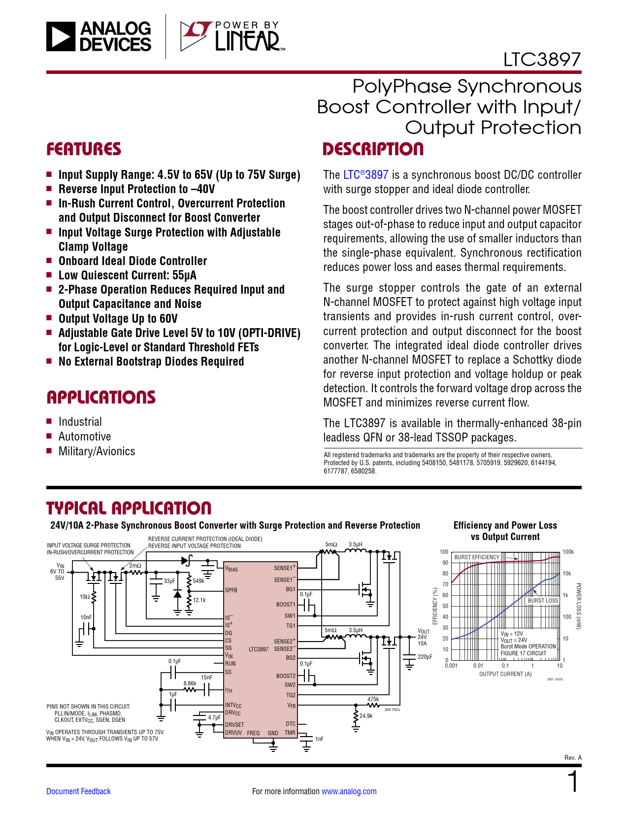

LTC3897 PolyPhase Synchronous Boost Controller with Input/ Output Protection
FEATURES DESCRIPTION
n
Input Supply Range: 4.5V to 65V (Up to 75V Surge)
The LTC®3897 is a synchronous boost DC/DC controller n
Reverse Input Protection to –40V
with surge stopper and ideal diode controller. n
In-Rush Current Control, Overcurrent Protection
The boost controller drives two N-channel power MOSFET
and Output Disconnect for Boost Converter
stages out-of-phase to reduce input and output capacitor n
Input Voltage Surge Protection with Adjustable
requirements, allowing the use of smaller inductors than
Clamp Voltage
the single-phase equivalent. Synchronous rectification n
Onboard Ideal Diode Controller
reduces power loss and eases thermal requirements. n
Low Quiescent Current: 55µA
n
2-Phase Operation Reduces Required Input and
The surge stopper controls the gate of an external
Output Capacitance and Noise
N-channel MOSFET to protect against high voltage input n
Output Voltage Up to 60V
transients and provides in-rush current control, over- n
Adjustable Gate Drive Level 5V to 10V (OPTI-DRIVE)
current protection and output disconnect for the boost
for Logic-Level or Standard Threshold FETs
converter. The integrated ideal diode controller drives n
No External Bootstrap Diodes Required
another N-channel MOSFET to replace a Schottky diode for reverse input protection and voltage holdup or peak detection. It controls the forward voltage drop across the
APPLICATIONS
MOSFET and minimizes reverse current flow. n Industrial The LTC3897 is available in thermally-enhanced 38-pin n Automotive leadless QFN or 38-lead TSSOP packages. n Military/Avionics All registered trademarks and trademarks are the property of their respective owners. Protected by U.S. patents, including 5408150, 5481178, 5705919, 5929620, 6144194, 6177787, 6580258.
TYPICAL APPLICATION 24V/10A 2-Phase Synchronous Boost Converter with Surge Protection and Reverse Protection Efficiency and Power Loss
