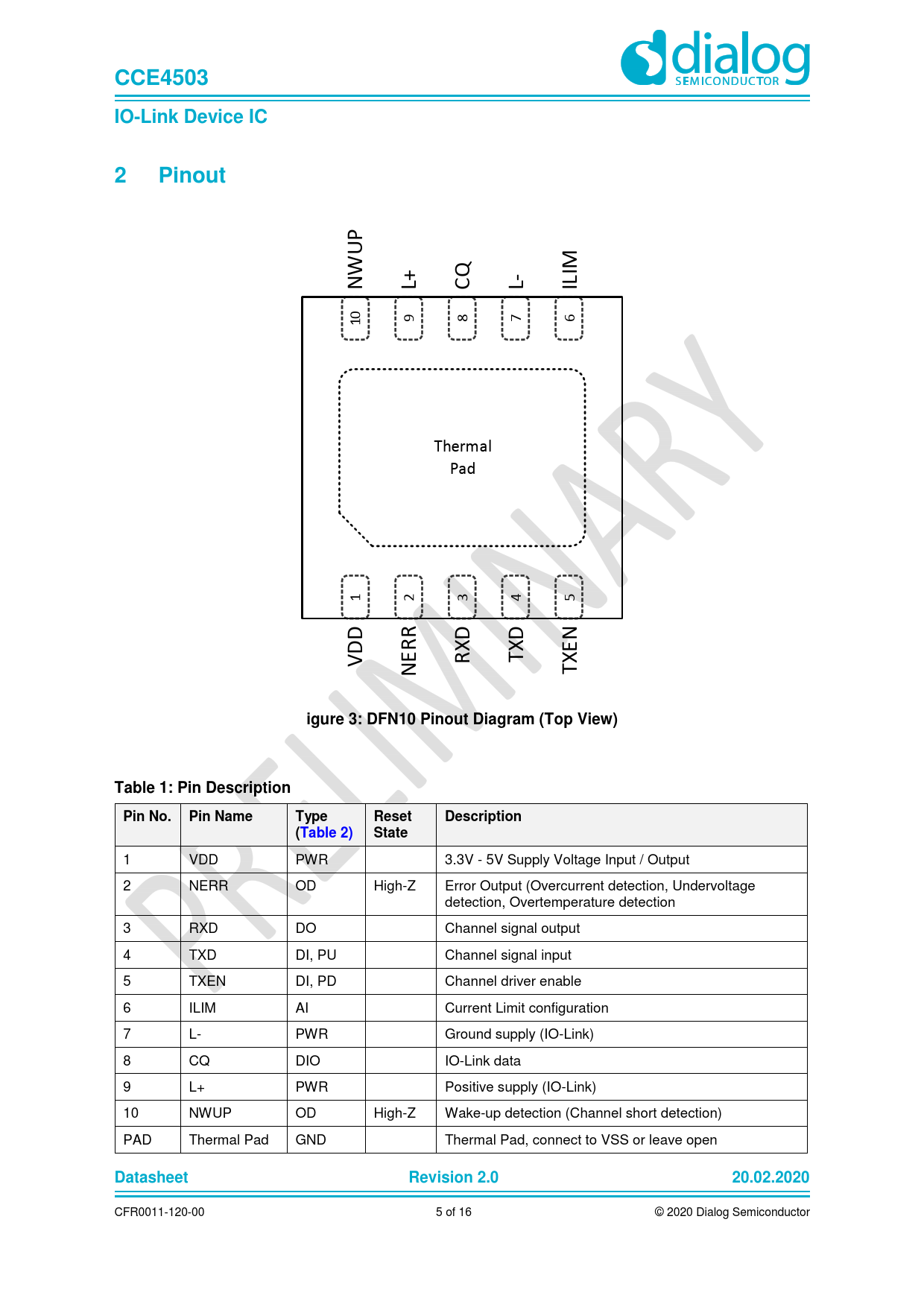

CCE4503 IO-Link Device IC 2 Pinout
P U W MI N +L CQ -L LI 10 9 8 7 6 Thermal Pad 1 2 3 4 5 D R D D N D R X X E V E R T X N T
igure 3: DFN10 Pinout Diagram (Top View) Table 1: Pin Description Pin No. Pin Name Type Reset Description (Table 2) State
1 VDD PWR 3.3V - 5V Supply Voltage Input / Output 2 NERR OD High-Z Error Output (Overcurrent detection, Undervoltage detection, Overtemperature detection 3 RXD DO Channel signal output 4 TXD DI, PU Channel signal input 5 TXEN DI, PD Channel driver enable 6 ILIM AI Current Limit configuration 7 L- PWR Ground supply (IO-Link) 8 CQ DIO IO-Link data 9 L+ PWR Positive supply (IO-Link) 10 NWUP OD High-Z Wake-up detection (Channel short detection) PAD Thermal Pad GND Thermal Pad, connect to VSS or leave open
