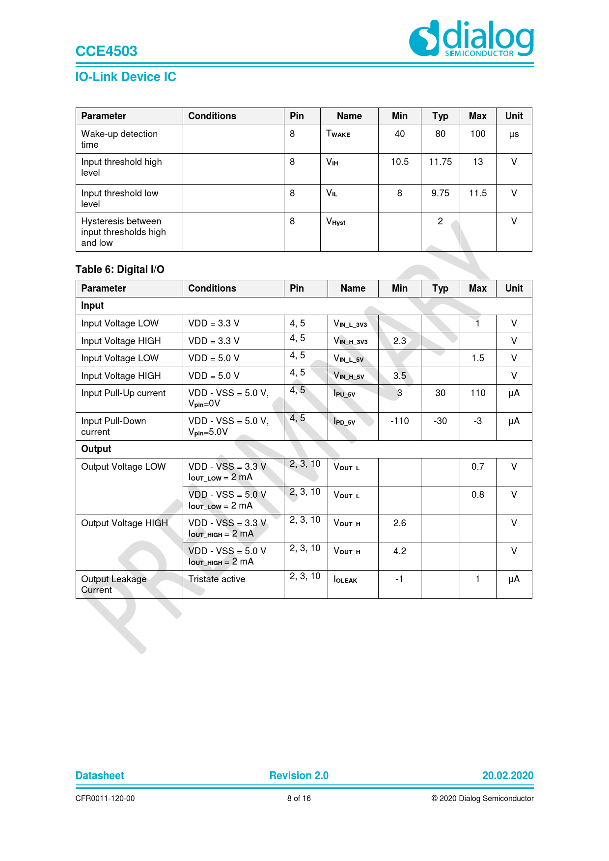

CCE4503. IO-Link Device IC. Parameter. Conditions. Pin. Name. Min. Typ. Max. Unit. WAKE. Hyst. Table 6: Digital I/O. Input. IN_L_3V3. IN_H_3V3. IN_L_5V
CCE4503 IO-Link Device IC Parameter Conditions Pin Name Min Typ Max Unit
Wake-up detection 8 T
WAKE
40 80 100 µs time Input threshold high 8 V
IH
10.5 11.75 13 V level Input threshold low 8 V
IL
8 9.75 11.5 V level Hysteresis between 8 V
Hyst
2 V input thresholds high and low
Table 6: Digital I/O Parameter Conditions Pin Name Min Typ Max Unit Input
Input Voltage LOW VDD = 3.3 V 4, 5 V
IN_L_3V3
1 V Input Voltage HIGH VDD = 3.3 V 4, 5 V
IN_H_3V3
2.3 V Input Voltage LOW VDD = 5.0 V 4, 5 V
IN_L_5V
1.5 V Input Voltage HIGH VDD = 5.0 V 4, 5 V
IN_H_5V
3.5 V Input Pull-Up current VDD - VSS = 5.0 V, 4, 5 I
PU_5V
3 30 110 µA V
pin
=0V Input Pull-Down VDD - VSS = 5.0 V, 4, 5 I
PD_5V
-110 -30 -3 µA current V
pin
=5.0V
Output
Output Voltage LOW VDD - VSS = 3.3 V 2, 3, 10 V
OUT_L
0.7 V I
OUT_LOW
= 2 mA VDD - VSS = 5.0 V 2, 3, 10 V
OUT_L
0.8 V I
OUT_LOW
= 2 mA Output Voltage HIGH VDD - VSS = 3.3 V 2, 3, 10 V
OUT_H
2.6 V I
OUT_HIGH
OUT_H
4.2 V I
OUT_HIGH
= 2 mA Output Leakage Tristate active 2, 3, 10 I
OLEAK
-1 1 µA Current
