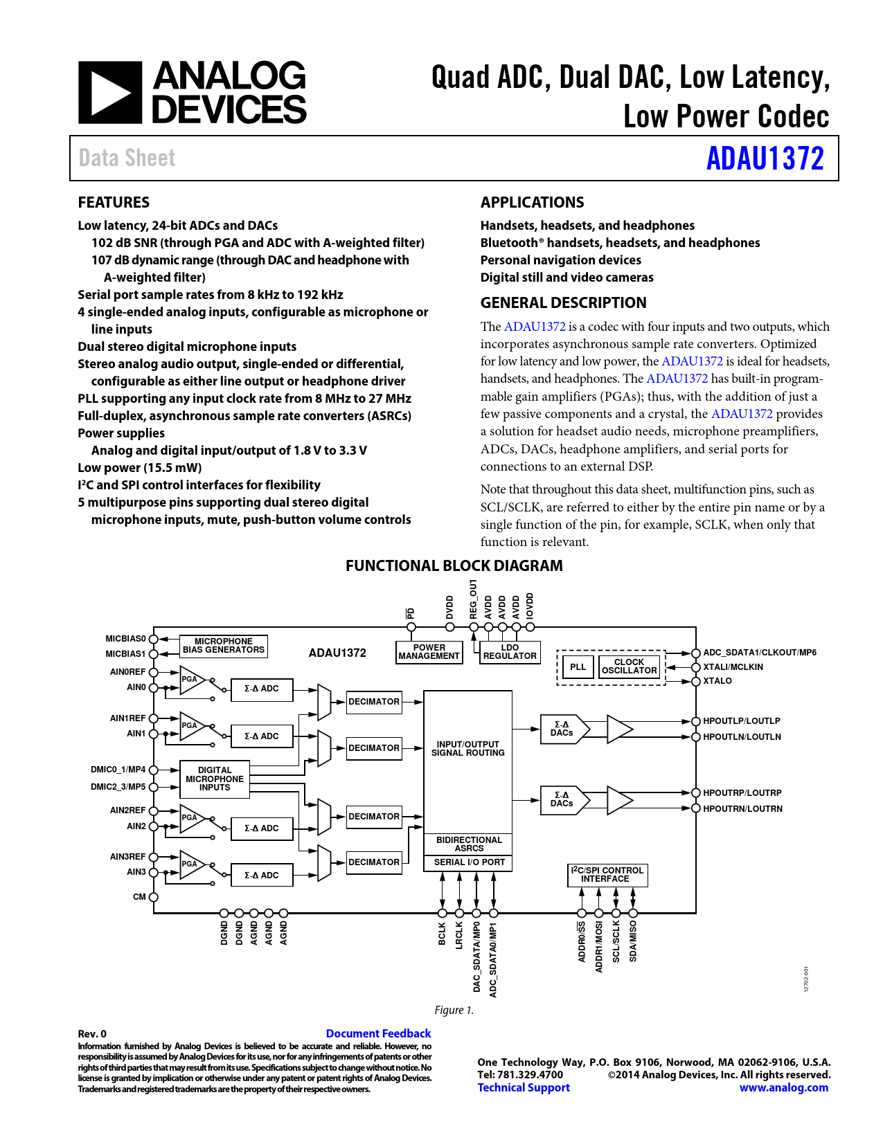

Quad ADC, Dual DAC, Low Latency,. Low Power Codec. Data Sheet. ADAU1372. FEATURES. APPLICATIONS. Low latency, 24-bit ADCs and DACs
Quad ADC, Dual DAC, Low Latency, Low Power Codec Data Sheet ADAU1372 FEATURES APPLICATIONS Low latency, 24-bit ADCs and DACs Handsets, headsets, and headphones 102 dB SNR (through PGA and ADC with A-weighted filter) Bluetooth® handsets, headsets, and headphones 107 dB dynamic range (through DAC and headphone with Personal navigation devices A-weighted filter) Digital still and video cameras Serial port sample rates from 8 kHz to 192 kHz GENERAL DESCRIPTION 4 single-ended analog inputs, configurable as microphone or line inputs
The ADAU1372 is a codec with four inputs and two outputs, which
Dual stereo digital microphone inputs
incorporates asynchronous sample rate converters. Optimized
Stereo analog audio output, single-ended or differential,
for low latency and low power, the ADAU1372 is ideal for headsets,
configurable as either line output or headphone driver
handsets, and headphones. The ADAU1372 has built-in program-
PLL supporting any input clock rate from 8 MHz to 27 MHz
mable gain amplifiers (PGAs); thus, with the addition of just a
Full-duplex, asynchronous sample rate converters (ASRCs)
few passive components and a crystal, the ADAU1372 provides
Power supplies
a solution for headset audio needs, microphone preamplifiers,
Analog and digital input/output of 1.8 V to 3.3 V
ADCs, DACs, headphone amplifiers, and serial ports for
Low power (15.5 mW)
connections to an external DSP.
I2C and SPI control interfaces for flexibility
Note that throughout this data sheet, multifunction pins, such as
5 multipurpose pins supporting dual stereo digital
SCL/SCLK, are referred to either by the entire pin name or by a
microphone inputs, mute, push-button volume controls
single function of the pin, for example, SCLK, when only that function is relevant.
FUNCTIONAL BLOCK DIAGRAM UT _O D DD G DD DD DD D PD DV RE AV AV AV IOV MICBIAS0 MICROPHONE BIAS GENERATORS POWER LDO MICBIAS1 ADAU1372 MANAGEMENT REGULATOR ADC_SDATA1/CLKOUT/MP6 CLOCK PLL XTALI/MCLKIN AIN0REF OSCILLATOR PGA XTALO AIN0 Σ-Δ ADC DECIMATOR AIN1REF HPOUTLP/LOUTLP PGA Σ-Δ AIN1 Σ-Δ ADC DACs HPOUTLN/LOUTLN DECIMATOR INPUT/OUTPUT SIGNAL ROUTING DMIC0_1/MP4 DIGITAL MICROPHONE DMIC2_3/MP5 INPUTS HPOUTRP/LOUTRP Σ-Δ DACs AIN2REF HPOUTRN/LOUTRN PGA DECIMATOR AIN2 Σ-Δ ADC BIDIRECTIONAL ASRCS AIN3REF PGA DECIMATOR SERIAL I/O PORT AIN3 I2C/SPI CONTROL Σ-Δ ADC INTERFACE CM K 0 K 1 S I ND ND ND ND ND P P S S O LK SO M C M DG DG AG AG AG M BCL RCL /MI A/ L A0/ L/S A C DAT ADDR0/ S SD DAT ADDR1/
001
DAC_S
12702-
ADC_S
Figure 1.
