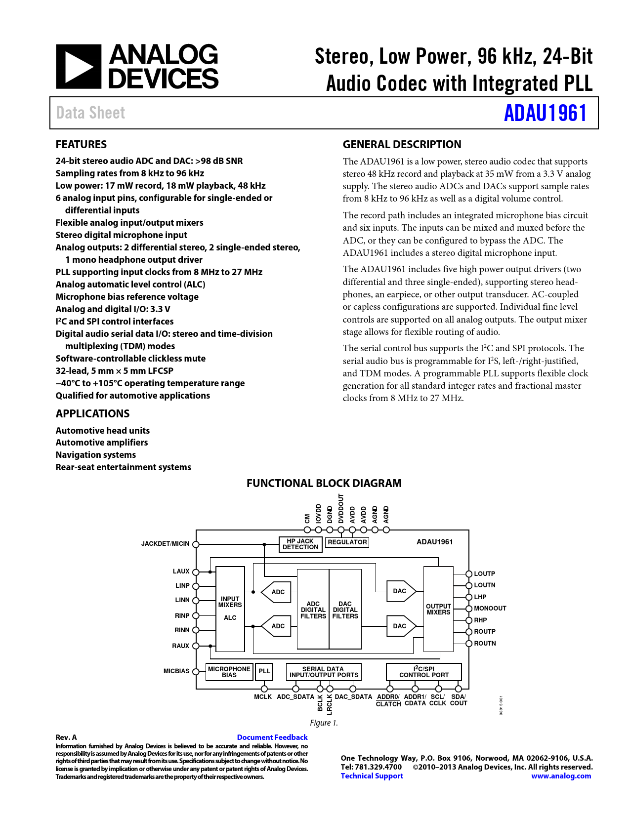

Stereo, Low Power, 96 kHz, 24-Bit Audio Codec with Integrated PLL Data Sheet ADAU1961 FEATURES GENERAL DESCRIPTION 24-bit stereo audio ADC and DAC: >98 dB SNR
The ADAU1961 is a low power, stereo audio codec that supports
Sampling rates from 8 kHz to 96 kHz
stereo 48 kHz record and playback at 35 mW from a 3.3 V analog
Low power: 17 mW record, 18 mW playback, 48 kHz
supply. The stereo audio ADCs and DACs support sample rates
6 analog input pins, configurable for single-ended or
from 8 kHz to 96 kHz as well as a digital volume control.
differential inputs
The record path includes an integrated microphone bias circuit
Flexible analog input/output mixers
and six inputs. The inputs can be mixed and muxed before the
Stereo digital microphone input
ADC, or they can be configured to bypass the ADC. The
Analog outputs: 2 differential stereo, 2 single-ended stereo,
ADAU1961 includes a stereo digital microphone input.
1 mono headphone output driver PLL supporting input clocks from 8 MHz to 27 MHz
The ADAU1961 includes five high power output drivers (two
Analog automatic level control (ALC)
differential and three single-ended), supporting stereo head-
Microphone bias reference voltage
phones, an earpiece, or other output transducer. AC-coupled
Analog and digital I/O: 3.3 V
or capless configurations are supported. Individual fine level
I2C and SPI control interfaces
controls are supported on all analog outputs. The output mixer
Digital audio serial data I/O: stereo and time-division
stage allows for flexible routing of audio.
multiplexing (TDM) modes
The serial control bus supports the I2C and SPI protocols. The
Software-controllable clickless mute
serial audio bus is programmable for I2S, left-/right-justified,
32-lead, 5 mm × 5 mm LFCSP
and TDM modes. A programmable PLL supports flexible clock
−40°C to +105°C operating temperature range
generation for al standard integer rates and fractional master
Qualified for automotive applications
clocks from 8 MHz to 27 MHz.
APPLICATIONS Automotive head units Automotive amplifiers Navigation systems Rear-seat entertainment systems FUNCTIONAL BLOCK DIAGRAM UT D D ND DDO DD DD ND ND CM IOV DG DV AV AV AG AG HP JACK REGULATOR JACKDET/MICIN ADAU1961 DETECTION LAUX LOUTP LINP LOUTN ADC DAC LHP LINN INPUT MIXERS ADC DAC OUTPUT MONOOUT DIGITAL DIGITAL MIXERS RINP ALC FILTERS FILTERS RHP ADC DAC RINN ROUTP RAUX ROUTN MICROPHONE MICBIAS PLL SERIAL DATA I2C/SPI BIAS INPUT/OUTPUT PORTS CONTROL PORT MCLK ADC_SDATA K K DAC_SDATA ADDR0/ ADDR1/ SCL/ SDA/
