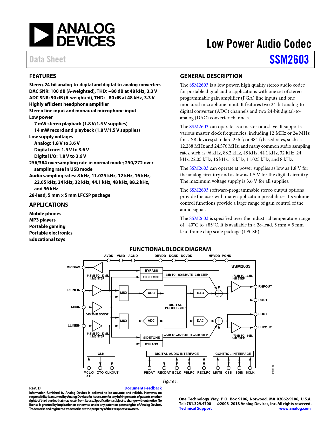

Low Power Audio Codec Data Sheet SSM2603 FEATURES GENERAL DESCRIPTION Stereo, 24-bit analog-to-digital and digital-to-analog converters
The SSM2603 is a low power, high quality stereo audio codec
DAC SNR: 100 dB (A-weighted), THD: −80 dB at 48 kHz, 3.3 V
for portable digital audio applications with one set of stereo
ADC SNR: 90 dB (A-weighted), THD: −80 dB at 48 kHz, 3.3 V
programmable gain amplifier (PGA) line inputs and one
Highly efficient headphone amplifier
monaural microphone input. It features two 24-bit analog-to-
Stereo line input and monaural microphone input
digital converter (ADC) channels and two 24-bit digital-to-
Low power
analog (DAC) converter channels.
7 mW stereo playback (1.8 V/1.5 V supplies)
The SSM2603 can operate as a master or a slave. It supports
14 mW record and playback (1.8 V/1.5 V supplies)
various master clock frequencies, including 12 MHz or 24 MHz
Low supply voltages
for USB devices; standard 256 f
Analog: 1.8 V to 3.6 V
S or 384 fS based rates, such as 12.288 MHz and 24.576 MHz; and many common audio sampling
Digital core: 1.5 V to 3.6 V
rates, such as 96 kHz, 88.2 kHz, 48 kHz, 44.1 kHz, 32 kHz, 24
Digital I/O: 1.8 V to 3.6 V
kHz, 22.05 kHz, 16 kHz, 12 kHz, 11.025 kHz, and 8 kHz.
256/384 oversampling rate in normal mode; 250/272 over- sampling rate in USB mode
The SSM2603 can operate at power supplies as low as 1.8 V for
Audio sampling rates: 8 kHz, 11.025 kHz, 12 kHz, 16 kHz,
the analog circuitry and as low as 1.5 V for the digital circuitry.
22.05 kHz, 24 kHz, 32 kHz, 44.1 kHz, 48 kHz, 88.2 kHz,
The maximum voltage supply is 3.6 V for all supplies.
and 96 kHz
The SSM2603 software-programmable stereo output options
28-lead, 5 mm × 5 mm LFCSP package
provide the user with many application possibilities. Its volume
APPLICATIONS
control functions provide a large range of gain control of the audio signal.
Mobile phones MP3 players
The SSM2603 is specified over the industrial temperature range
Portable gaming
of −40°C to +85°C. It is available in a 28-lead, 5 mm × 5 mm
Portable electronics
lead frame chip scale package (LFCSP).
Educational toys FUNCTIONAL BLOCK DIAGRAM AVDD VMID AGND DBVDD DGND DCVDD HPVDD PGND MICBIAS SSM2603 BYPASS –34.5dB TO +33dB, –6dB TO –15dB/MUTE –3dB STEP SIDETONE –73dB TO +6dB, 1.5dB STEP 1dB STEP RHPOUT RLINEIN MUX ADC DAC ROUT DIGITAL MICIN PROCESSOR 0dB/20dB BOOST LOUT MUX ADC DAC LLINEIN LHPOUT –34.5dB TO +33dB, –6dB TO –15dB/MUTE –3dB STEP 1.5dB STEP –73dB TO +6dB, SIDETONE 1dB STEP BYPASS CLK DIGITAL AUDIO INTERFACE CONTROL INTERFACE
