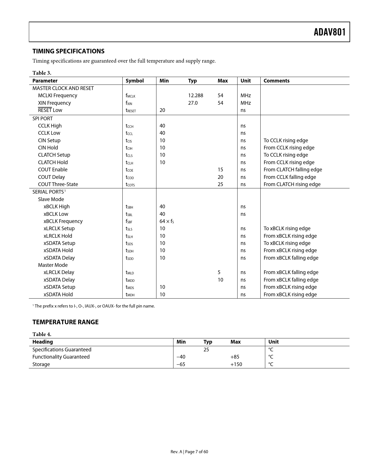

ADAV801 TIMING SPECIFICATIONS
Timing specifications are guaranteed over the full temperature and supply range.
Table 3. Parameter Symbol Min Typ Max Unit Comments
MASTER CLOCK AND RESET MCLKI Frequency fMCLK 12.288 54 MHz XIN Frequency fXIN 27.0 54 MHz RESET Low tRESET 20 ns SPI PORT CCLK High tCCH 40 ns CCLK Low tCCL 40 ns CIN Setup tCIS 10 ns To CCLK rising edge CIN Hold tCIH 10 ns From CCLK rising edge CLATCH Setup tCLS 10 ns To CCLK rising edge CLATCH Hold tCLH 10 ns From CCLK rising edge COUT Enable tCOE 15 ns From CLATCH falling edge COUT Delay tCOD 20 ns From CCLK falling edge COUT Three-State tCOTS 25 ns From CLATCH rising edge SERIAL PORTS1 Slave Mode xBCLK High tSBH 40 ns xBCLK Low tSBL 40 ns xBCLK Frequency fSBF 64 × fS xLRCLK Setup tSLS 10 ns To xBCLK rising edge xLRCLK Hold tSLH 10 ns From xBCLK rising edge xSDATA Setup tSDS 10 ns To xBCLK rising edge xSDATA Hold tSDH 10 ns From xBCLK rising edge xSDATA Delay tSDD 10 ns From xBCLK falling edge Master Mode xLRCLK Delay tMLD 5 ns From xBCLK falling edge xSDATA Delay tMDD 10 ns From xBCLK falling edge xSDATA Setup tMDS 10 ns From xBCLK rising edge xSDATA Hold tMDH 10 ns From xBCLK rising edge 1 The prefix x refers to I-, O-, IAUX-, or OAUX- for the full pin name.
TEMPERATURE RANGE Table 4. Heading Min Typ Max Unit
Specifications Guaranteed 25 °C Functionality Guaranteed −40 +85 °C Storage −65 +150 °C Rev. A | Page 7 of 60 Document Outline FEATURES FUNCTIONAL BLOCK DIAGRAM APPLICATIONS GENERAL DESCRIPTION TABLE OF CONTENTS REVISION HISTORY SPECIFICATIONS TEST CONDITIONS ADAV801 SPECIFICATIONS TIMING SPECIFICATIONS TEMPERATURE RANGE ABSOLUTE MAXIMUM RATINGS ESD CAUTION PIN CONFIGURATION AND FUNCTION DESCRIPTIONS TYPICAL PERFORMANCE CHARACTERISTICS FUNCTIONAL DESCRIPTION ADC SECTION Programmable Gain Amplifier (PGA) Analog Σ-Δ Modulator Automatic Level Control (ALC) Attack Mode No Recovery Mode Normal Recovery Mode Limited Recovery Mode Selecting a Sample Rate DAC SECTION Selecting a Sample Rate SAMPLE RATE CONVERTER (SRC) FUNCTIONAL OVERVIEW Conceptual High Interpolation Model Hardware Model SRC Architecture PLL SECTION S/PDIF TRANSMITTER AND RECEIVER Serial Digital Audio Transmission Standards Receiver Section Transmitter Operation Autobuffering Interrupts SERIAL DATA PORTS Clocking Scheme Datapath INTERFACE CONTROL SPI INTERFACE BLOCK READS AND WRITES REGISTER DESCRIPTIONS SRC and Clock Control—Address 0000000 (0x00) S/PDIF Loopback Control—Address 0000011 (0x03) Playback Port Control—Address 0000100 (0x04) Auxiliary Input Port—Address 0000101 (0x05) Record Port Control—Address 0000110 (0x06) Auxiliary Output Port—Address 0000111 (0x07) Group Delay and Mute—Address 0001000 (0x08) Receiver Configuration 1—Address 0001001 (0x09) Receiver Configuration 2—Address 0001010 (0x0A) Receiver Buffer Configuration—Address 0001011 (0x0B) Transmitter Control—Address 0001100 (0x0C) Transmitter Buffer Configuration—Address 0001101 (0x0D) Channel Status Switch Buffer and Transmitter—Address 0001110 (0x0E) Transmitter Message Zeros Most Significant Byte—Address 0001111 (0x0F) Transmitter Message Zeros Least Significant Byte—Address 0010000 (0x10) Autobuffer—Address 0010001 (0x11) Sample Rate Ratio MSB—Address 0010010 (0x12) Sample Rate Ratio LSB—Address 0010011 (0x13) Preamble-C MSB—Address 0010100 (0x14) Preamble-C LSB—Address 0010101 (0x15) Preamble-D MSB—Address 0010110 (0x16) Preamble-D LSB—Address 0010111 (0x17) Receiver Error—Address 0011000 (0x18) Receiver Error Mask—Address 0011001 (0x19) Sample Rate Converter Error—Address 0011010 (0x1A) Sample Rate Converter Error Mask—Address 0011011 (0x1B) Interrupt Status—Address 0011100 (0x1C) Interrupt Status Mask—Address 0011101 (0x1D) Mute and De-Emphasis—Address 0011110 (0x1E) NonAudio Preamble Type—Address 0011111 (0x1F) Receiver Channel Status Buffer—Address 0100000 to Address 0110111 (0x20 to 0x37) Transmitter Channel Status Buffer—Address 0111000 to Address 1001111 (0x38 to 0x4F) Receiver User Bit Buffer Indirect Address— Address 1010000 (0x50) Receiver User Bit Buffer Data—Address 1010001 (0x51) Transmitter User Bit Buffer Indirect Address—Address 1010010 (0x52) Transmitter User Bit Buffer Data—Address 1010011 (0x53) Q Subcode CRCError Status—Address 1010100 (0x54) Q Subcode Buffer—Address 0x55 to Address 0x5E Datapath Control Register 1—Address 1100010 (0x62) Datapath Control Register 2—Address 1100011 (0x63) DAC Control Register 1—Address 1100100 (0x64) DAC Control Register 2—Address 1100101 (0x65) DAC Control Register 3—Address 1100110 (0x66) DAC Control Register 4—Address 1100111 (0x67) DAC Left Volume—Address 1101000 (0x68) DAC Right Volume—Address 1101001 (0x69) DAC Left Peak Volume—Address 1101010 (0x6A) DAC Right Peak Volume—Address 1101011 (0x6B) ADC Left Channel PGA Gain—Address 1101100 (0x6C) ADC Right Channel PGA Gain—Address 1101101 (0x6D) ADC Control Register 1—Address 1101110 (0x6E) ADC Control Register 2—Address 1101111 (0x6F) ADC Left Volume—Address 1110000 (0x70) ADC Right Volume—Address 1110001 (0x71) ADC Left Peak Volume—Address 1110010 (0x72) ADC Right Peak Volume—Address 1110011 (0x73) PLL Control Register 1—Address 1110100 (0x74) PLL Control Register 2—Address 1110101 (0x75) Internal Clocking Control Register 1—Address 1110110 (0x76) Internal Clocking Control Register 2—Address 1110111 (0x77) PLL Clock Source Register—Address 1111000 (0x78) PLL Output Enable—Address 1111010 (0x7A) ALC Control Register 1—Address 1111011 (0x7B) ALC Control Register 2— Address = 1111100 (0x7C) ALC Control Register 3—Address 1111101 (0x7D) LAYOUT CONSIDERATIONS ADC DAC PLL RESET AND POWER-DOWN CONSIDERATIONS OUTLINE DIMENSIONS ORDERING GUIDE
