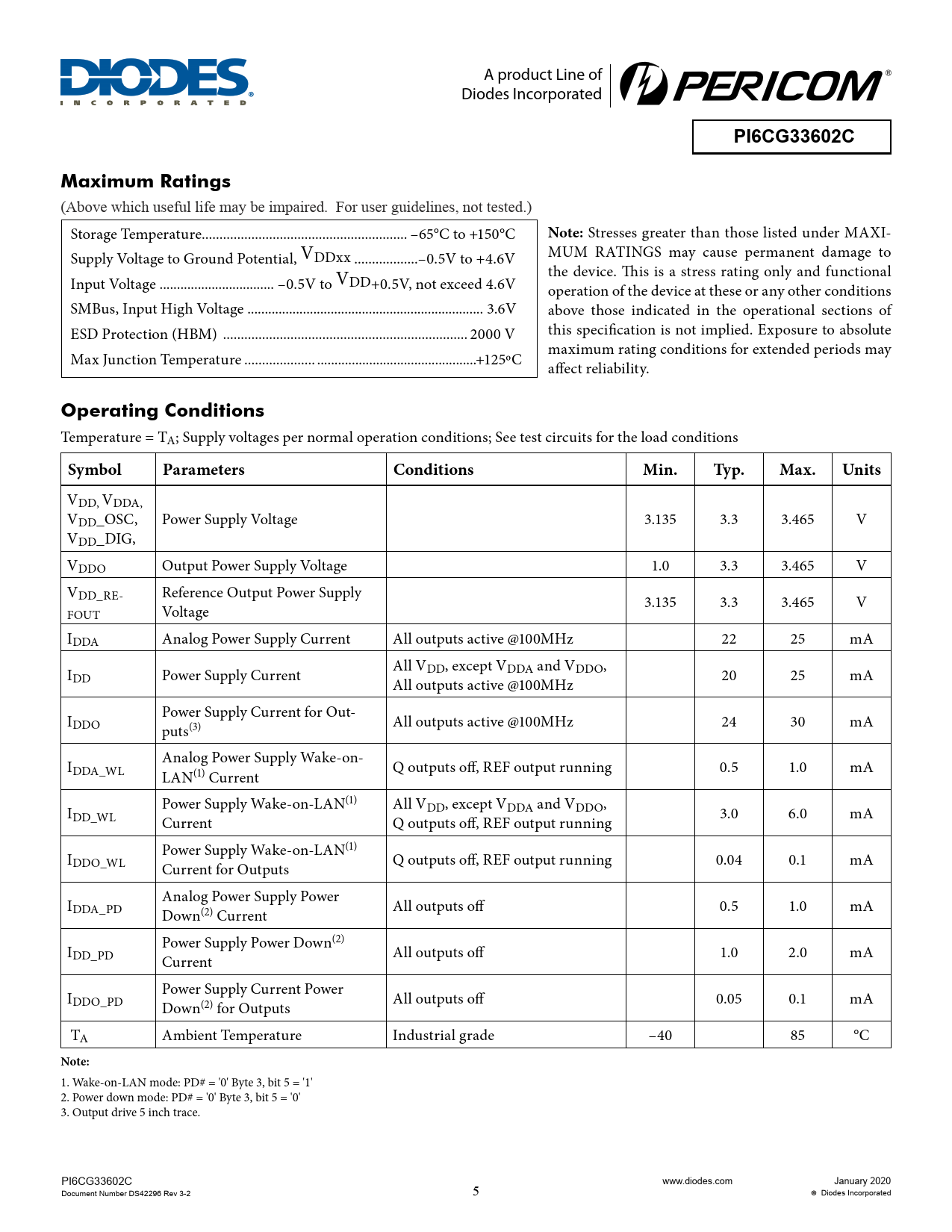

PI6CG33602C Maximum Ratings
(Above which useful life may be impaired. For user guidelines, not tested.) Storage Temperature .. –65°C to +150°C
Note:
Stresses greater than those listed under MAXI- Supply Voltage to Ground Potential, VDDxx ..–0.5V to +4.6V MUM RATINGS may cause permanent damage to the device. This is a stress rating only and functional Input Voltage ... –0.5V to VDD+0.5V, not exceed 4.6V operation of the device at these or any other conditions SMBus, Input High Voltage .. 3.6V above those indicated in the operational sections of ESD Protection (HBM) ... 2000 V this specification is not implied. Exposure to absolute Max Junction Temperature ..+125ºC maximum rating conditions for extended periods may affect reliability.
Operating Conditions
Temperature = TA; Supply voltages per normal operation conditions; See test circuits for the load conditions
Symbol Parameters Conditions Min. Typ. Max. Units
VDD, VDDA, VDD_OSC, Power Supply Voltage 3.135 3.3 3.465 V VDD_DIG, VDDO Output Power Supply Voltage 1.0 3.3 3.465 V VDD_RE- Reference Output Power Supply FOUT Voltage 3.135 3.3 3.465 V IDDA Analog Power Supply Current All outputs active @100MHz 22 25 mA IDD Power Supply Current All VDD, except VDDA and VDDO, All outputs active @100MHz 20 25 mA I Power Supply Current for Out- DDO puts(3) All outputs active @100MHz 24 30 mA I Analog Power Supply Wake-on- DDA_WL LAN(1) Current Q outputs off, REF output running 0.5 1.0 mA I Power Supply Wake-on-LAN(1) All VDD, except VDDA and VDDO, DD_WL Current Q outputs off, REF output running 3.0 6.0 mA I Power Supply Wake-on-LAN(1) DDO_WL Current for Outputs Q outputs off, REF output running 0.04 0.1 mA I Analog Power Supply Power DDA_PD Down(2) Current All outputs off 0.5 1.0 mA I Power Supply Power Down(2) DD_PD Current All outputs off 1.0 2.0 mA I Power Supply Current Power DDO_PD Down(2) for Outputs All outputs off 0.05 0.1 mA TA Ambient Temperature Industrial grade –40 85 °C
Note:
1. Wake-on-LAN mode: PD# = '0' Byte 3, bit 5 = '1' 2. Power down mode: PD# = '0' Byte 3, bit 5 = '0' 3. Output drive 5 inch trace. PI6CG33602C www.diodes.com January 2020 Document Number DS42296 Rev 3-2 5 Diodes Incorporated
