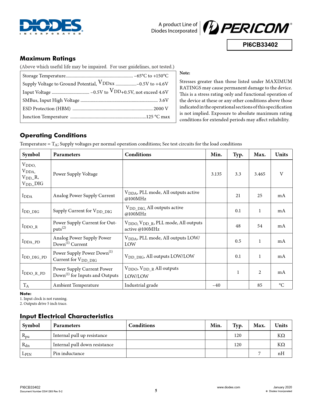

PI6CB33402 Maximum Ratings
(Above which useful life may be impaired. For user guidelines, not tested.) Storage Temperature .. –65°C to +150°C
Note:
Supply Voltage to Ground Potential, VDDxx ..–0.5V to +4.6V Stresses greater than those listed under MAXIMUM RATINGS may cause permanent damage to the device. Input Voltage ... –0.5V to VDD+0.5V, not exceed 4.6V This is a stress rating only and functional operation of SMBus, Input High Voltage .. 3.6V the device at these or any other conditions above those ESD Protection (HBM) ... 2000 V indicated in the operational sections of this specification is not implied. Exposure to absolute maximum rating Junction Temperature ..125 °C max conditions for extended periods may affect reliability.
Operating Conditions
Temperature = TA; Supply voltages per normal operation conditions; See test circuits for the load conditions
Symbol Parameters Conditions Min. Typ. Max. Units
VDDO, VDDA, V Power Supply Voltage 3.135 3.3 3.465 V DD_R, VDD_DIG IDDA Analog Power Supply Current VDDA, PLL mode, All outputs active @100MHz 21 25 mA I VDD_DIG, All outputs active DD_DIG Supply Current for VDD_DIG @100MHz 0.1 1 mA I Power Supply Current for Out- VDDO, VDD_R, PLL mode, All outputs DDO_R puts(2) active @100MHz 48 54 mA I Analog Power Supply Power VDDA, PLL mode, All outputs LOW/ DDA_PD Down(1) Current LOW 0.5 1 mA I Power Supply Power Down(1) DD_DIG_PD Current for V VDD_DIG, All outputs LOW/LOW 0.1 1 mA DD_DIG V I Power Supply Current Power DDO, VDD_R All outputs DDO_R_PD Down(1) for Inputs and Outputs 1 2 mA LOW/LOW TA Ambient Temperature Industrial grade –40 85 °C
Note:
1. Input clock is not running. 2. Outputs drive 5 inch trace.
Input Electrical Characteristics Symbol Parameters Conditions Min. Typ. Max. Units
Rpu Internal pull up resistance 120 KW Rdn Internal pull down resistance 120 KW LPIN Pin inductance 7 nH PI6CB33402 www.diodes.com January 2020 Document Number DS41293 Rev 5-2 5 Diodes Incorporated
