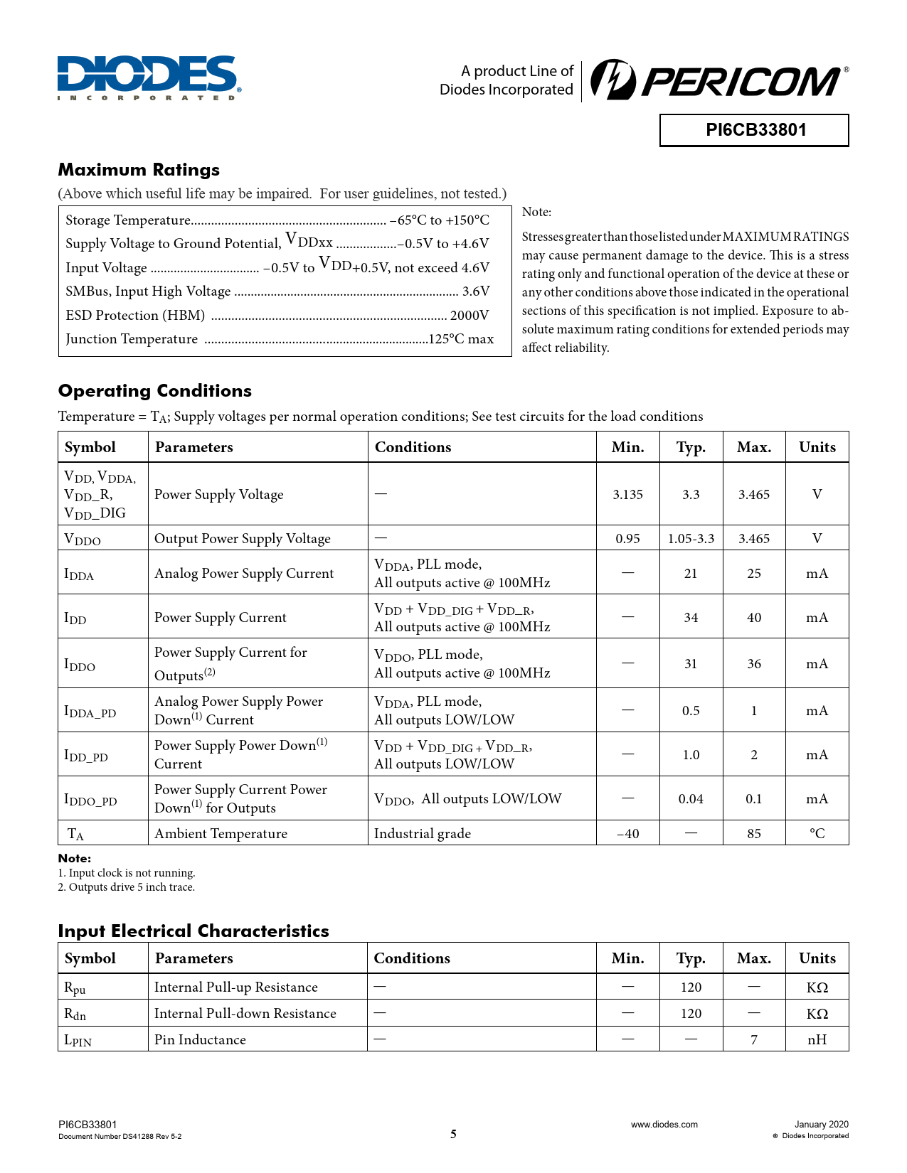

PI6CB33801 Maximum Ratings
(Above which useful life may be impaired. For user guidelines, not tested.) Storage Temperature .. –65°C to +150°C Note: Supply Voltage to Ground Potential, VDDxx ..–0.5V to +4.6V Stresses greater than those listed under MAXIMUM RATINGS may cause permanent damage to the device. This is a stress Input Voltage ... –0.5V to VDD+0.5V, not exceed 4.6V rating only and functional operation of the device at these or SMBus, Input High Voltage .. 3.6V any other conditions above those indicated in the operational ESD Protection (HBM) .. 2000V sections of this specification is not implied. Exposure to ab- Junction Temperature ...125°C max solute maximum rating conditions for extended periods may affect reliability.
Operating Conditions
Temperature = TA; Supply voltages per normal operation conditions; See test circuits for the load conditions
Symbol Parameters Conditions Min. Typ. Max. Units
VDD, VDDA, VDD_R, Power Supply Voltage — 3.135 3.3 3.465 V VDD_DIG VDDO Output Power Supply Voltage — 0.95 1.05-3.3 3.465 V IDDA Analog Power Supply Current VDDA, PLL mode, All outputs active @ 100MHz — 21 25 mA IDD Power Supply Current VDD + VDD_DIG + VDD_R, All outputs active @ 100MHz — 34 40 mA Power Supply Current for I VDDO, PLL mode, DDO Outputs(2) All outputs active @ 100MHz — 31 36 mA I Analog Power Supply Power VDDA, PLL mode, DDA_PD Down(1) Current All outputs LOW/LOW — 0.5 1 mA I Power Supply Power Down(1) VDD + VDD_DIG + VDD_R, DD_PD Current All outputs LOW/LOW — 1.0 2 mA I Power Supply Current Power DDO_PD Down(1) for Outputs VDDO, All outputs LOW/LOW — 0.04 0.1 mA TA Ambient Temperature Industrial grade –40 — 85 °C
Note:
1. Input clock is not running. 2. Outputs drive 5 inch trace.
Input Electrical Characteristics Symbol Parameters Conditions Min. Typ. Max. Units
Rpu Internal Pull-up Resistance — — 120 — KW Rdn Internal Pull-down Resistance — — 120 — KW LPIN Pin Inductance — — — 7 nH PI6CB33801 www.diodes.com January 2020 Document Number DS41288 Rev 5-2 5 Diodes Incorporated
