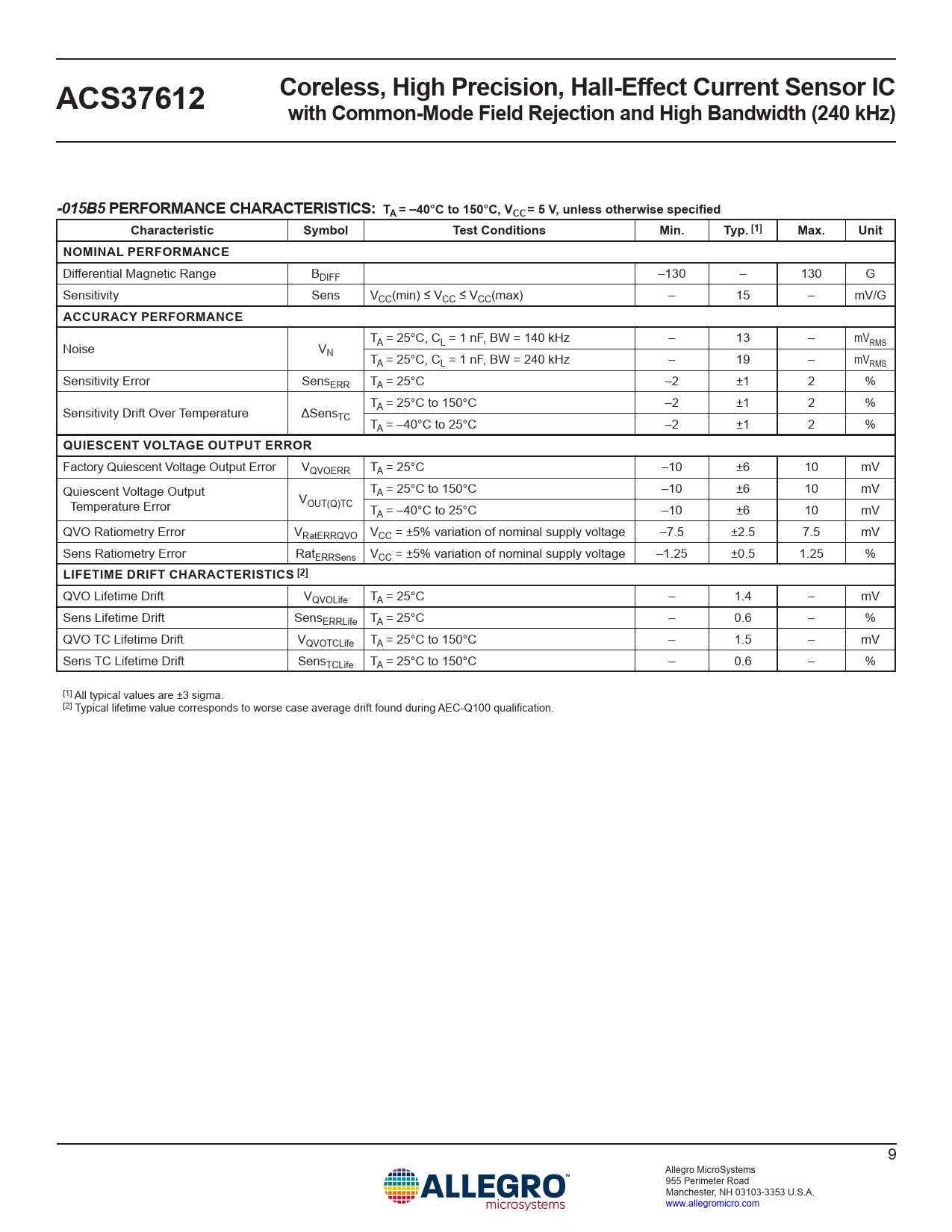

| Manufacturer | Allegro |
| Description | Coreless, High Precision, Hall-Effect Current Sensor IC with Common-Mode Field Rejection and High Bandwidth (240 kHz) |
| Pages / Page | 22 / 9 — Coreless, High Precision, Hall-Effect Current Sensor IC. ACS37612 |
| File Format / Size | PDF / 2.3 Mb |
Coreless, High Precision, Hall-Effect Current Sensor IC ACS37612 with Common-Mode Field Rejection and High Bandwidth (240 kHz) -015B5 PERFORMANCE CHARACTERISTICS: TA = –40°C to 150°C, VCC = 5 V, unless otherwise specified Characteristic Symbol Test Conditions Min. Typ. [1] Max. Unit NOMINAL PERFORMANCE
Differential Magnetic Range BDIFF –130 – 130 G Sensitivity Sens VCC(min) ≤ VCC ≤ VCC(max) – 15 – mV/G
ACCURACY PERFORMANCE
T Noise V A = 25°C, CL = 1 nF, BW = 140 kHz – 13 – mVRMS N TA = 25°C, CL = 1 nF, BW = 240 kHz – 19 – mVRMS Sensitivity Error SensERR TA = 25°C –2 ±1 2 % T Sensitivity Drift Over Temperature ΔSens A = 25°C to 150°C –2 ±1 2 % TC TA = –40°C to 25°C –2 ±1 2 %
QUIESCENT VOLTAGE OUTPUT ERROR
Factory Quiescent Voltage Output Error VQVOERR TA = 25°C –10 ±6 10 mV Quiescent Voltage Output TA = 25°C to 150°C –10 ±6 10 mV Temperature Error VOUT(Q)TC TA = –40°C to 25°C –10 ±6 10 mV QVO Ratiometry Error VRatERRQVO VCC = ±5% variation of nominal supply voltage –7.5 ±2.5 7.5 mV Sens Ratiometry Error RatERRSens VCC = ±5% variation of nominal supply voltage –1.25 ±0.5 1.25 %
LIFETIME DRIFT CHARACTERISTICS [2]
QVO Lifetime Drift VQVOLife TA = 25°C – 1.4 – mV Sens Lifetime Drift SensERRLife TA = 25°C – 0.6 – % QVO TC Lifetime Drift VQVOTCLife TA = 25°C to 150°C – 1.5 – mV Sens TC Lifetime Drift SensTCLife TA = 25°C to 150°C – 0.6 – % [1] All typical values are ±3 sigma. [2] Typical lifetime value corresponds to worse case average drift found during AEC-Q100 qualification. 9 Allegro MicroSystems 955 Perimeter Road Manchester, NH 03103-3353 U.S.A. www.allegromicro.com
