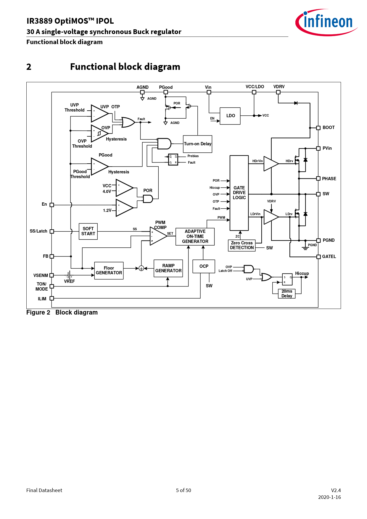

DescriptionA single-voltage synchronous Buck regulator
Pages / Page50 / 5 — OptiMOS™ IPOL. 30 A single-voltage synchronous Buck regulator. Functional …

OptiMOS™ IPOL. 30 A single-voltage synchronous Buck regulator. Functional block diagram. AGND. PGood. Vin. VCC/LDO. VDRV. UVP. POR. UVP OTP
OptiMOS™ IPOL 30 A single-voltage synchronous Buck regulator Functional block diagram AGND PGood Vin VCC/LDO VDRV UVP POR UVP OTP
IR OptiMOS™ IPOL 30 A single-voltage synchronous Buck regulator Functional block diagram 2 Functional block diagram AGND PGood Vin VCC/LDO VDRV AGND UVP POR UVP OTP Threshold
LDO VCC EN Fault AGND OVP BOOT
Hysteresis OVP Turn-on Delay Threshold PVin PGood
Q S
Prebias HDrVin HDrv
+ Q R
Fault
PGood Hysteresis Threshold PHASE POR VCC
Hiccup GATE
POR 4.0V DRIVE OVP SW LOGIC OTP VDRV En
Fault 1.2V
LDrVin LDrv PWM PWM COMP SOFT SS SS/Latch + ADAPTIVE START SET - ON-TIME ZC - + PGND GENERATOR Zero Cross PGND DETECTION SW FB GATEL Floor
RAMP OCP OVP GENERATOR Latch Off GENERATOR Hiccup
VSENM
S Q
UVP VREF
R
TON/ SW MODE 20ms Delay ILIM Figure 2 Block diagram
